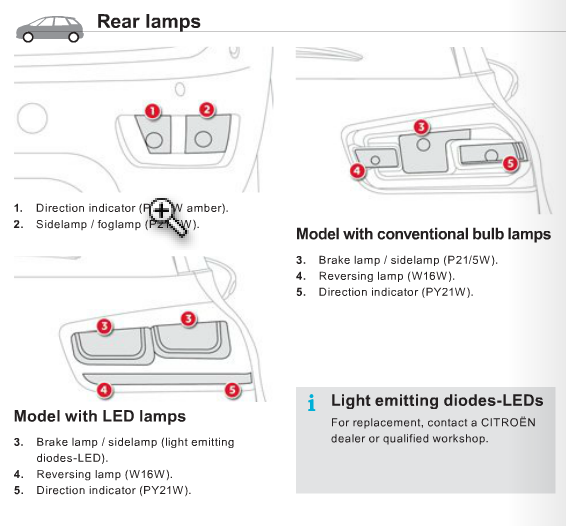

I think you'll find the reversing bulbs are a W16W bulb and these are shown as filament bulbs....
Only the rear brake and sidelight bulbs are LEDs... the indicator and reversing are standard filament bulbs...
So you may be able to find an LED equivalent of the W16W.

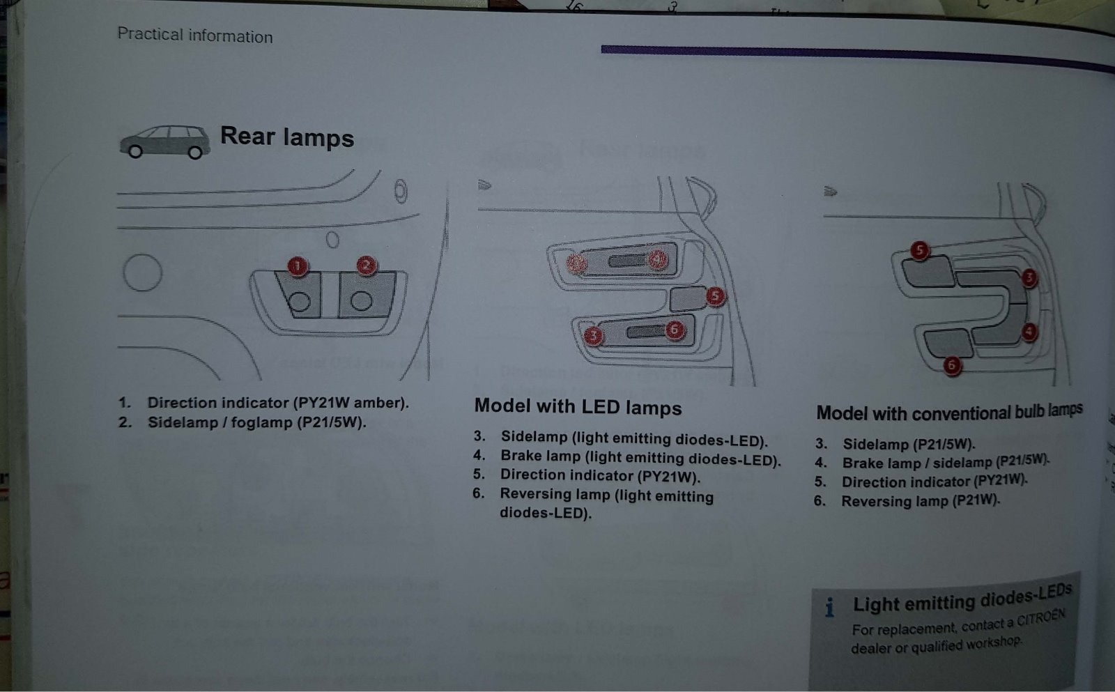

GiveMeABreak wrote: 05 Feb 2019, 10:51 What's your VIN - I can check these out
VIN - VF7**************[VIN obfuscated, can be read by forum staff]
Oh, how I wish you were right, but you have displayed the wrong model in this instance. I have the Executive+ which has all-LED (except the indicators) at the rear.
I went outside and "The Boss" switched the various lights ON/OFF, and I can confirm that all but the Indicators at the rear are LEDs.
I will hopefully attach a photo of my handbook (page 278) showing my rear lights (center set, labelled MODEL WITH LED LIGHTS). My firsat attempt destroyed the post and it vanished, never to be seen again.
