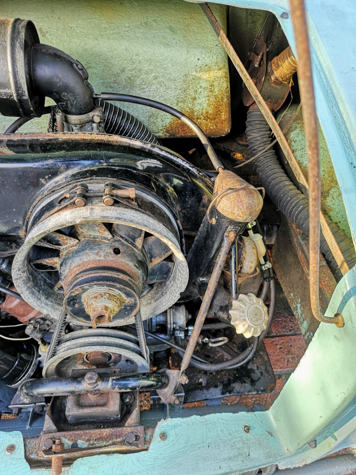

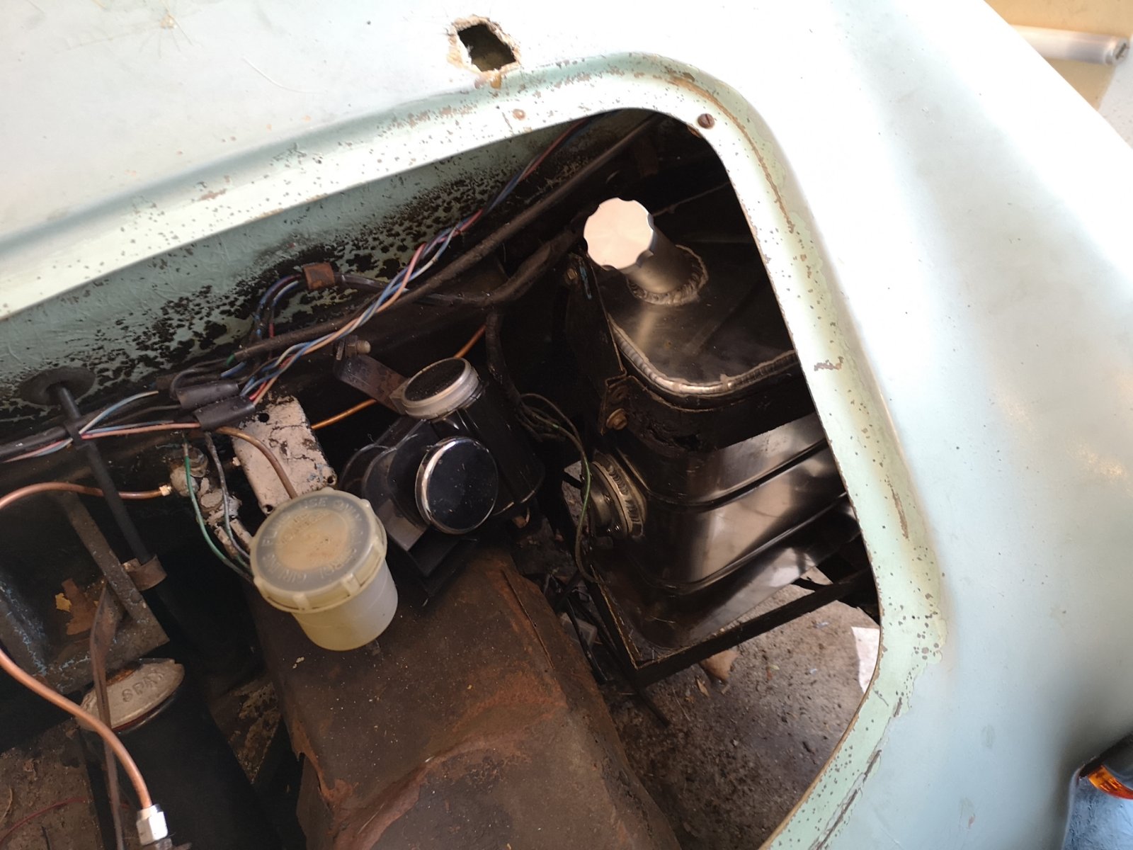

This evening I've made a start getting this lot fitted.
Have only done the section between the fuel pump and carburettor so far, but it won't take long to finish things off.
I have changed the hose routing from the factory spec slightly. It originally crossed from the offside to nearside inside the engine cowling. I'm not a fan of that for two reasons, even if it does help reduce engine bay clutter. Firstly, I can't see it without removing the cowl. Secondly, having the hose essentially sitting on top of the cylinder barrels just seems like a recipe for heat soak issues after the engine stops (shouldn't be an issue with the engine running given the huge amount of airflow).
Instead I've run it along the rear edge of the cowling on the outside where it's easier to keep an eye on. Also means if it did spring a leak, it would dump fuel over the gearbox casing and front of the engine cowl rather than straight over the cylinder barrels and exhaust.

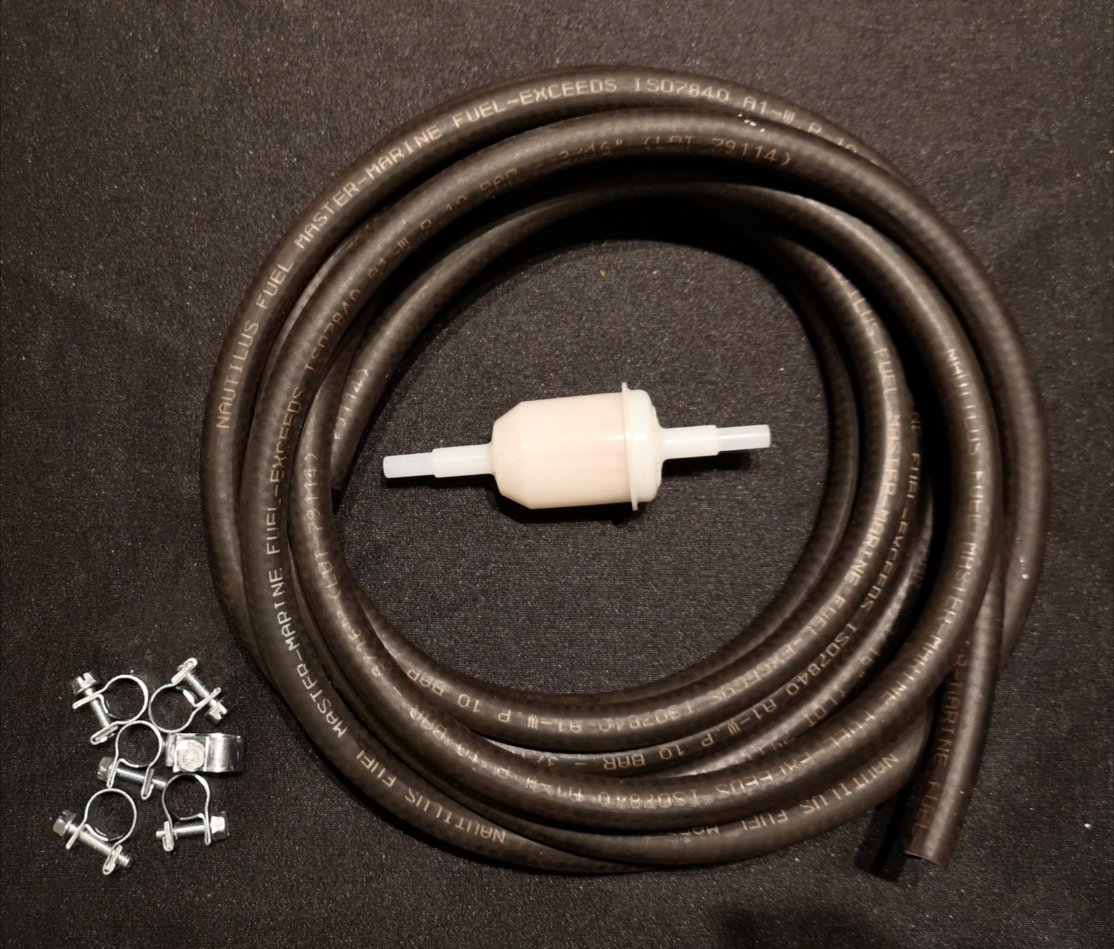

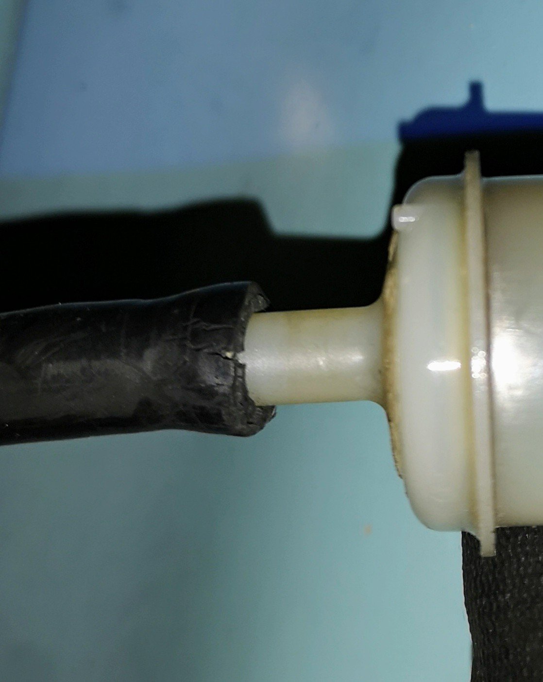

The marine grade fuel hose is meant to be really resistant to abrasion etc compared to normal automotive stuff, so that will hopefully won't be too big a worry.
Very much hoping that this won't be the scene in six months time.
That's supposedly injection suitable, unleaded compatible hose from a major national car part supply chain. Shudder to think of the possible consequences of that having a few tens of PSI behind it, buried under a car where it can't be seen. Let's see if the marine stuff does better. It feels like a far higher quality product, and it's really noticeable how much better it holds its shape when the hose clips are tightened up than the normal stuff.
There was originally no fuel filter fitted other than a coarse screen in the pump, so I've added an in-line one between the pump and carb, I've positioned it near to the offside cylinder head so it's pretty easy to check visually. Need to try to find some clear filters, all the ones Motorserv stock these days are opaque it seems, makes it harder to see what state the filter is in until it's really filthy.

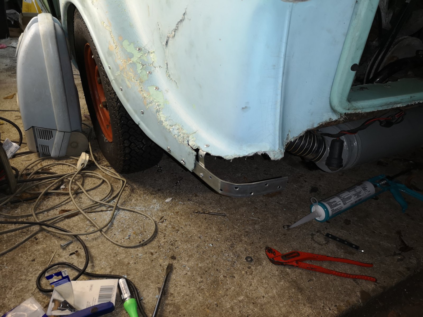

The rear valance/bumper was next on the list. This essentially doubles as a shield to keep people clear of the exhaust, so needs to be in place in some form.
I've now started to put together the framework for this and also put some strapping in place to shore up the rear quarter on the nearside which has a bunch of cracks in it.
The plethora of bolts and rivets you can see here are now tying all the bits of bodywork here together via straps on the other side of the panel.
There will be glass fibre repairs done here as well, matting most likely applied from behind the panel, but actually having things tied together now will make that a lot easier. The whole corner is now reasonably rigid rather than distinctly floppy (to the extent that it used to wobble comedically when the engine was idling).

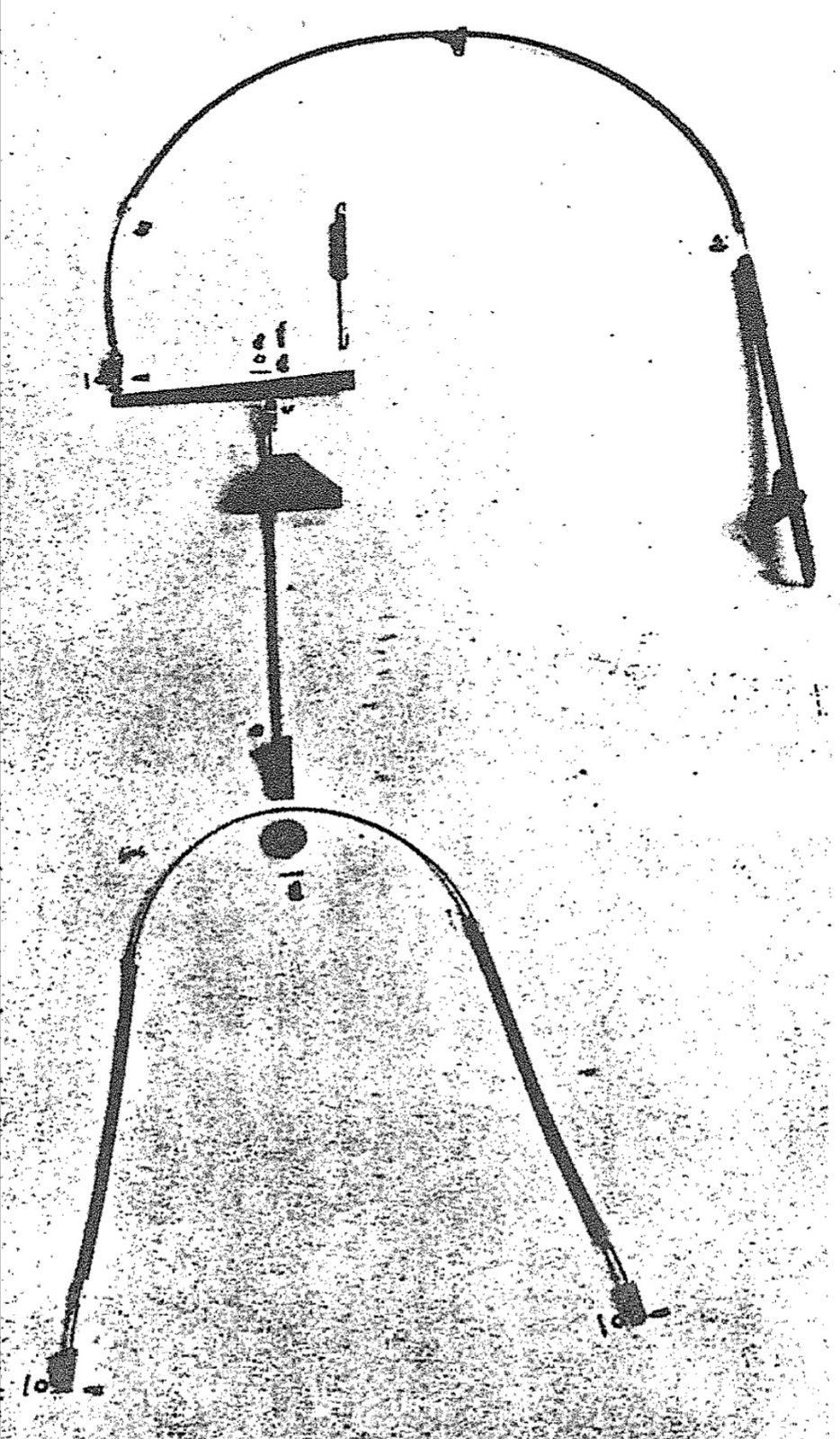

Is the handbrake on the front or rear wheels Zel?
Zelandeth
- Posts: 5289
- Joined: 16 Nov 2014, 23:36
- x 1592

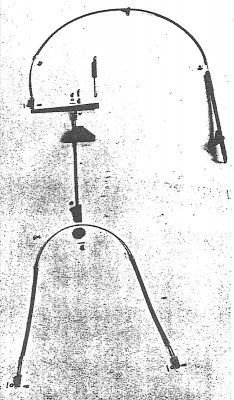

Rear wheels. The only interesting thing about that side of things is the way they have a lever setup in the middle of things to reduce the effort you need to apply to the hand control. According to the manual this provides an 8:1 mechanical advantage, important I imagine when the target market are likely to be quite frail.
This is what the cable and lever assembly looks like off the car, courtesy of the workshop manual.
It remains to be seen how effective it is...

That's clever Zel
In so many ways they put so much thought and good engineering into the Invacar...

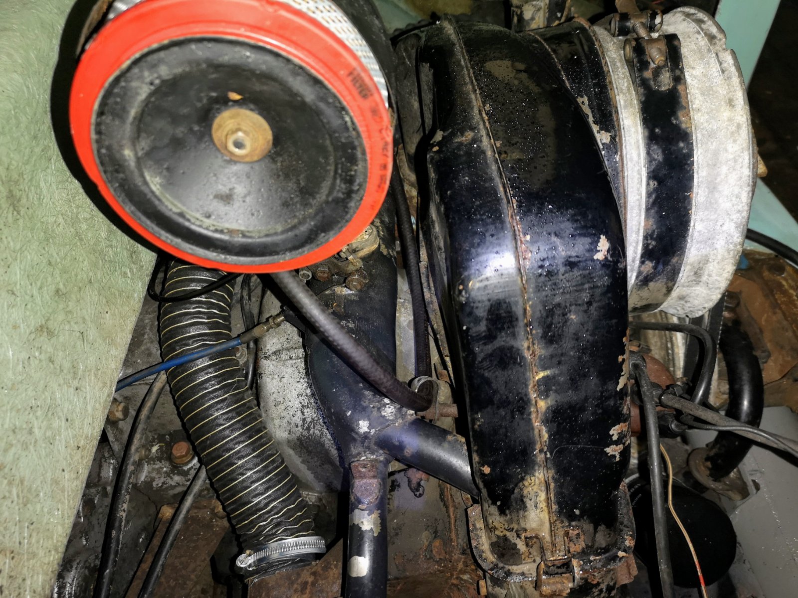

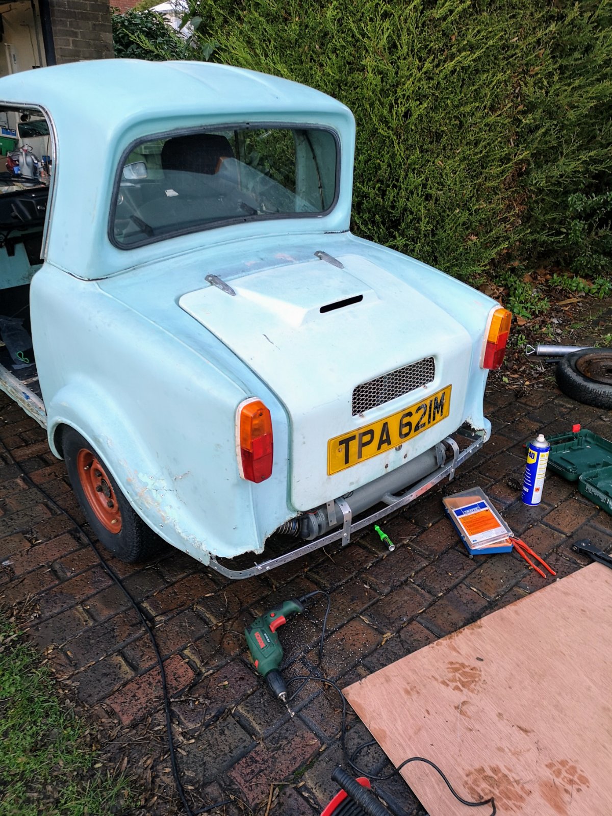

Actually some decent progress made today for a change.

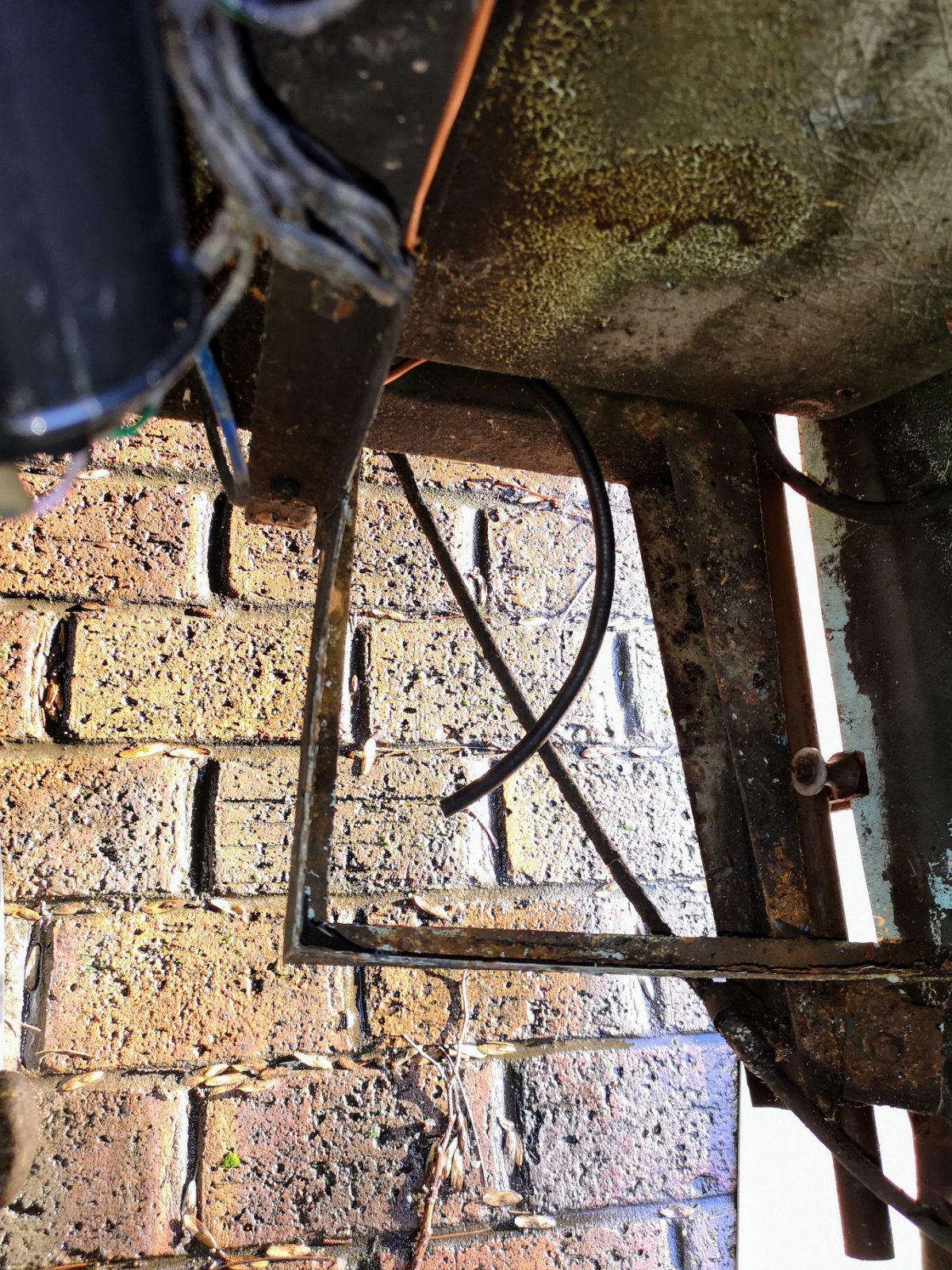

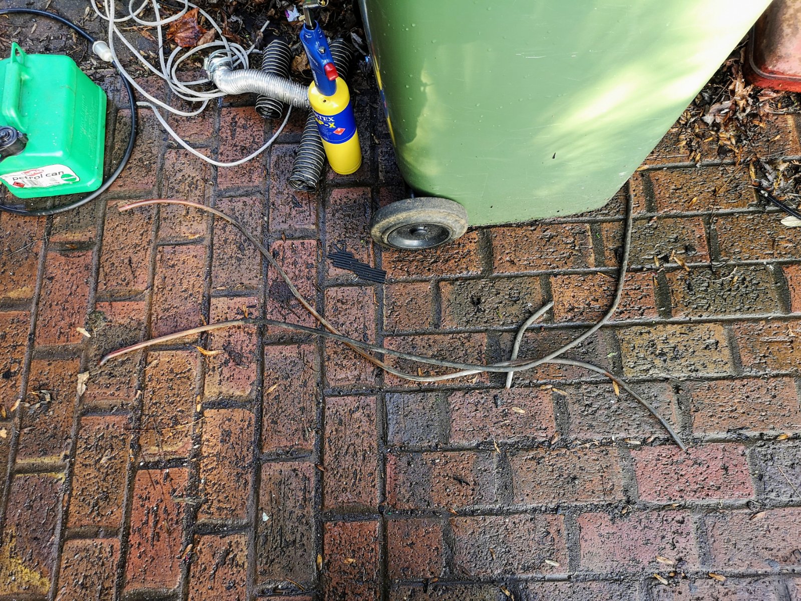

Having reversed out of the garage it was far easier to get at the fuel lines.
Ten minutes later all of the old fuel lines were off. Had to cut it into a couple of pieces to remove it as it is essentially impossible to bend.
No idea what this hose is made of...Absolute pain to cut whatever it is!
My guess as to how much hose I needed was correct pretty much to the inch. In case you wondered, you need five metres of hose. Tail is here waiting for the fuel tank up front.

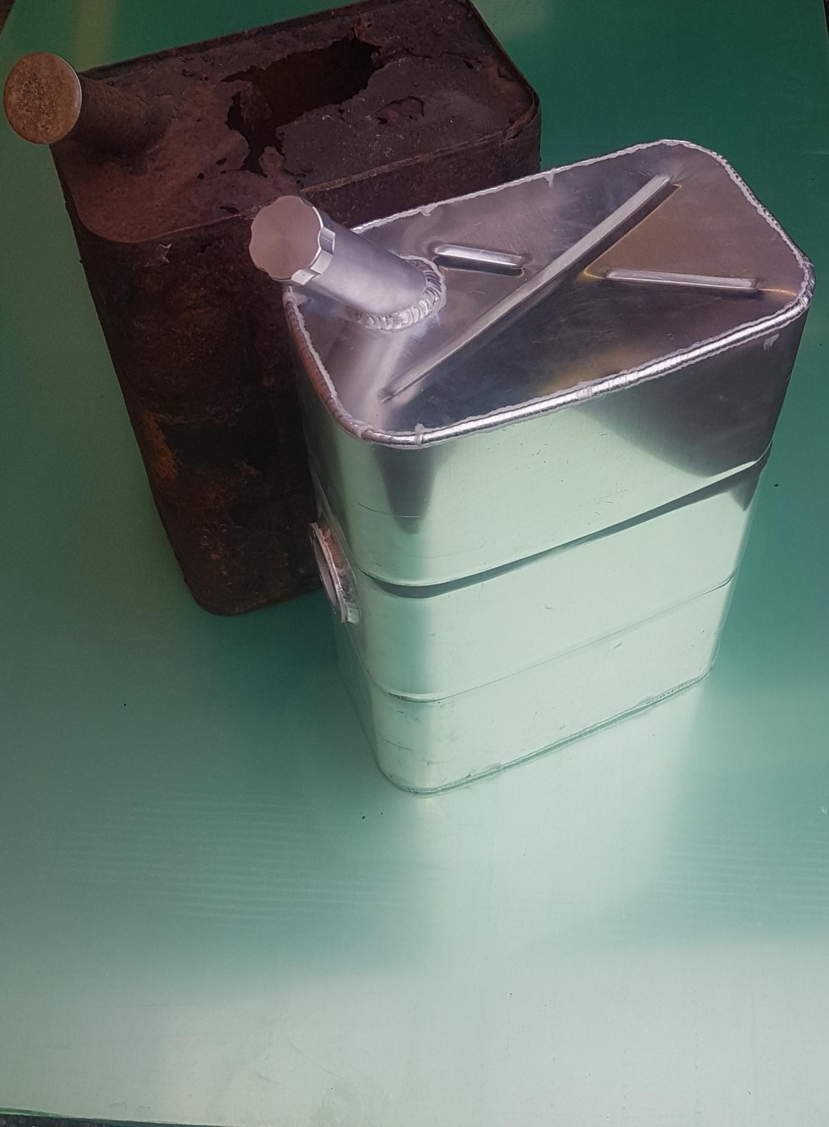

Speaking of the fuel tank, had an email from the company who have been making it for me to say that it's now ready for collection. A shame that you'll never see it once it's on the car.

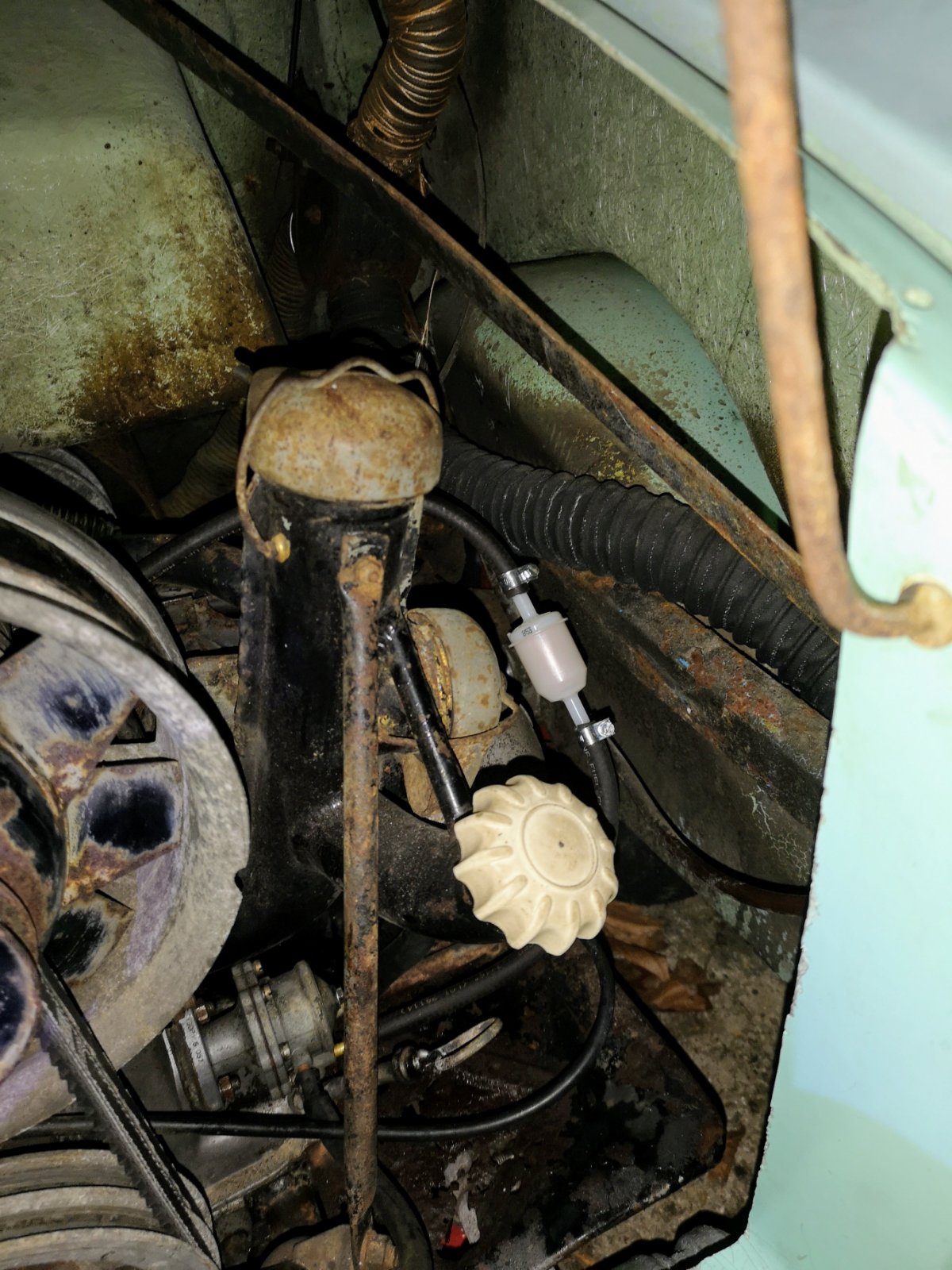

Fuel lines all finished up in the engine bay now as well.
The other task of the afternoon has been to start building up a framework to support the rear bumper as I come to actually build it up.
Just waiting on a response from a friend to see if I can rearrange a visit we'd got planned for tomorrow to see if I can rearrange it - if that can be moved easily I'll hopefully go and get the fuel tank tomorrow and get it fitted.
Then we might be looking at a (very, very, very, very) local road test and seeing if it's as downright terrifying to drive as I'm half expecting it to be.

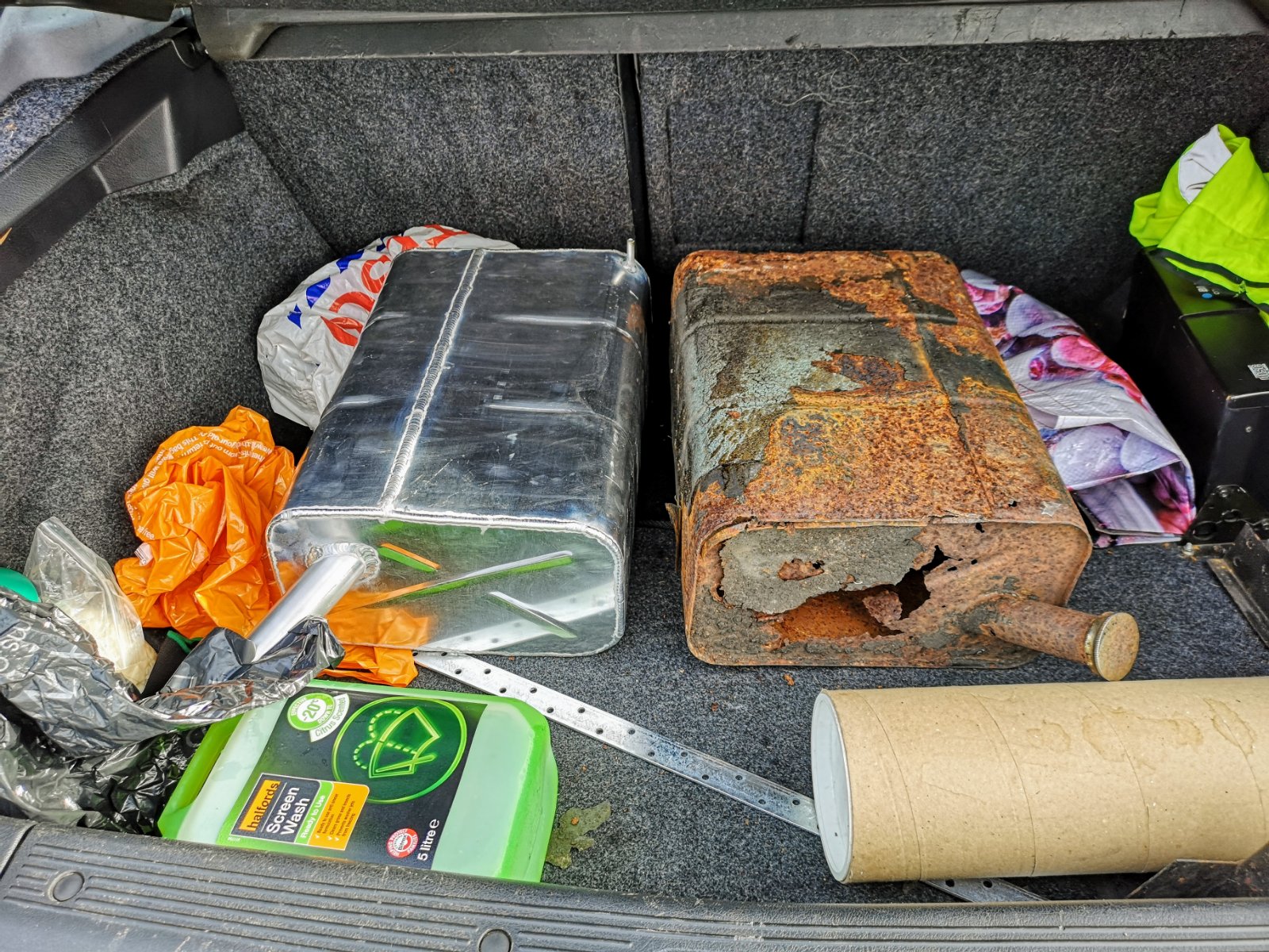

Look what I picked up today...
This was made for me by Fusion Fabrications, and I reckon they've done a really nice job of it. Well worth the £220 they charged for it I think.
Sadly won't have time to get it installed this evening - but suffice to say though it will be the first thing on my to do list for tomorrow!

Excellent! That tank looks ace
Did they do a new cap too or will you use the one from the old tank?

Jim: New cap has been provided. We would have liked to retain the original one as it's got a lovely dainty little retaining chain and satisfying bayonet locking action - sadly it's paper thin due to rust. The new one will feel far nicer to use once I've put a tiny smear of grease on the threads. Looks the part, milled from a solid chunk of aluminium.
I hadn't spotted till just now that Fusion have actually faithfully copied the reinforcing ribs stamped into the panels from the original too. Nice touch.
