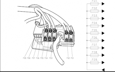

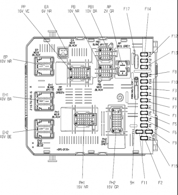

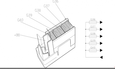

Fuses:
| Check on the BSI the following fuse: F13 (5A): Suspension ECU | Check on the BSI module (the cabin fusebox) the following fuse: Check Fuse G39 (10A): Electrohydraulic Suspension | Check on the Fuse Box from the battery: Fuse F01 (40A): Electropump Assembly - Electrohydraulic Suspension ECU |

Marc, two more questions:
- Where is this BSI located (and the fuses)?
- Fuse box from the battery? Where is that? Is it the red cover box between battery and fender? If so, how do I open it?

On left hand drive, the BSI is inside under the driver left hand side stowage tray - inside there, which will include the fuse box in the second diagram. The other fuse box is under the bonnet near the battery.

The fuse box near battery, you probably don’t mean the actual large fuse box? Those fuses look really strange and I cannot find that box.
