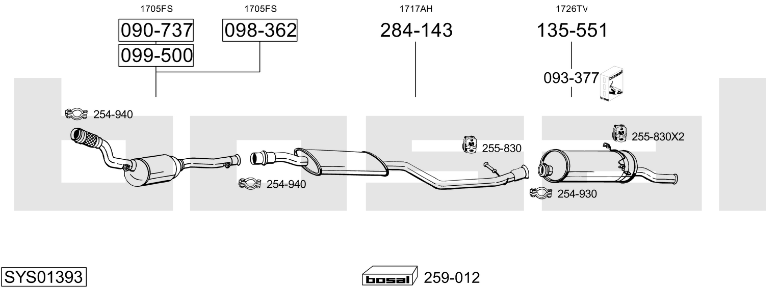

Looks like the front exhaust has dropped explaining the tractor sounds and I'm getting a P1336 error code through the OBD
Would anybody please be kind enough to have a diagram of the complete exhaust system??

You can see a diagram on the Bosal catalogue: http://www.bosal.com/en/catalog/exhaust ... 2/SYS01393
Looks like the front section flexi is also the cat, so it won't be cheap....

Image attached.

Wouldn't mind betting it's cracked the weld on the flexi, it can be welded if that's the case.
