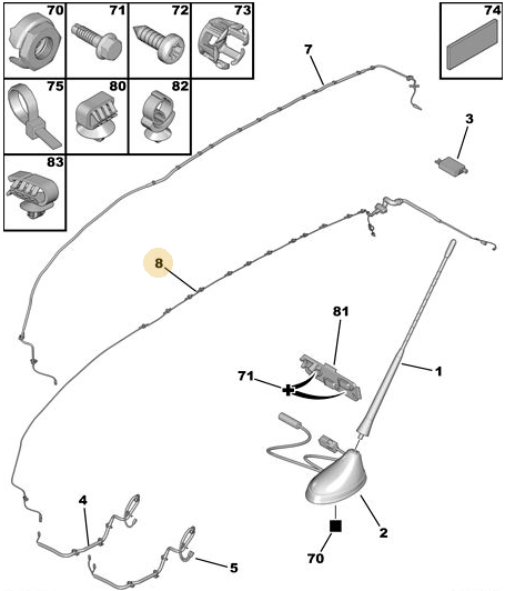

Don't expect to get good reception as DAB uses different frequencies and FM aerials are not ideal:
Long Wave - 148 to 283 kHz = 2020m to 1058m
Medium Wave - 526 to 1606 kHz = 570m to 187m
VHF/FM - 88 to 108 MHz = 3.4m to 2.8m (= Band II)
DAB - 175 to 230 MHz = 1.7m to 1.3m (= Band III)
On the back of the RT6:
The White connector is for FM1 & AM
The Grey connector is for FM2
The Blue is for GPS
In the following diagram, you only have the following parts fitted:
1) Aerial
2) Aerial Base
3) Radio Aerial Adapter
4) N/A
5)Aerial Cable (AM-FM1 / FM2 / GPS // DASHBOARD ZONE // ISO CONNECTION - DASHBOARD/STR CONNECTION LINK)
6) N/A
7) Aerial Cable (PASS COMPART ZONE // AM-FM1 / GPS // DASHBOARD/STR CONNECTION - AERIAL BASE CONNECTION LINK)
8)
AERIAL CABLE
PASS COMPART ZONE / TAILGATE // FM2 AERIAL ADAPTOR CONNECTION - STR / DASH CABLE CONNECTION LINK
I have obviously omitted the clips and fixings
