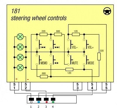

1 - 12v+ / lights on
2 - control line 1
3 - Gnd
4 - control line 2

Some real progress, and without having to use the (non-working) interface kit!
Sony customer support being quite useless at providing the required remote (steering wheel) control resistor values for the 3.5mm remote jack on the back of the radio.
Have finally managed to find that info online...
Have made up a bit of veroboard with some push-buttons and resistors, to test with the new Sony CDX-G1302 here, and now have proper control for
Vol+
Vol-
Mode/Source (radio, CD, USB...)
Mute
Seek+ (next)
Seek? (prev)
The other functions are not supported by this unit; the Memo and » (scan) buttons on the Citroen don't have equivalent functions either, so will be ignored.
Next job is to open up the steering wheel, and look at changing the original resistors for new ones.
The old Philips unit used a chain of 0R, 120R, 220R and 680R resistors, twice over, for SWC.
Getting there.

Success!
Opened up the steering wheel this afternoon, and fished out the small resistor p.c.b. tucked inside.
Finally decided not to modify it by way of changing its resistors, partly because doctoring it would be irreversible, also because it is rather miniature, and it's essentially built around the idea of two separate resistor chains and two output lines.
Opted simply to build another small board (same size, and the 5-way p.c.b. connector borrowed from the old one - easily unsoldered), on a piece of veroboard. A few recovered 4-way PC connectors were used to connect up the three sets of switches on the steering wheel. Each of the small switches has four connections: Gnd, Illumination, Output 1, Output 2.
The new board has to accommodate just the six new resistors in a chain, and the old p.c.b. connector.
The new Sony works on a single series chain of six resistors, with preferred values as in the document above.
Signal to radio/CD unit (3.5mm stereo jack; tip=signal, body=Gnd, centre band=NC)
2k2
|<----- Source (Mode) looking for 2k2
2k2
|<----- Att (Mute) 4k4
4k3
|<----- Seek+/Next (>>|) 8k8
3k3
|<----- Seek-/Prev (|<<) 12k
4k7
|<----- Vol+ 16k8
6k8
|_ <----- Vol- 23k6
All original parts have been preserved, in case anyone ever wants to revert to original equipment.
Autoleads, nul points. Sony customer support, nul points.
But real thanks to Marc for all the helpful hints!
