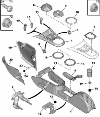

Thanks Marc, will order two more from my supplier first so all my blades with be functioning!
Would you be kind enough to supply the part numbers for the whole cigar lighter assembly and the drivers window switch? Once I manage to get the RD4 to sit in it's place that'll be me finished!
Had a bit of a scuff last week that buggered up the drivers door opening, got that done today as well

No worries here you go:
However, this lot are selling the cigar lighter and housing complete here for £12.45 delivered:
https://www.ebay.co.uk/itm/GENUINE-PEUG ... ctupt=true
Cigar lighter only: 822754 | 6554L7 Driver side window switch |

Thanks Marc, do you have the whole 12v socket code? Mine is knackered!

Re: Citroen C2 locking issue
15?
Thanks Marc, you're a Saint!
15 should be included in both parts in that last link Tom, the eBay seller is showing the lighter and the holder and light fitting.
Thanks Marc, someone was breaking one near me so I have the whole console! How to I get the connectors off for the windows? They seem seriously stubborn!
The window switches should be able to be removed with a trim removal tool. A flat blunt instrument should allow you so push in the plastic clips that hold it in - whether these are at the sides of the switch or at the front or back or both I can't say Tom - there are no details on it - but if you have the replacement switch to hand, I assume you'll be able to determine what parts you have to lever on to release it.
Bit fiddly but all done!
If I replace the passenger side with an automatic button would this work or are the windows equipped differently do you know Marc?
Just need to find somewhere tidy to hide my AUX lead and I think that'll be me finished at last!
Well done.
If you're referring to the sequential one-touch button then no, as these actually have a different motor for the sequential and standard type of window lift, and I suspect they are controlled differently too.
