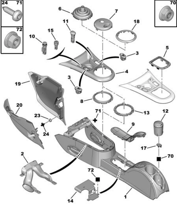

Thanks Marc, will order two more from my supplier first so all my blades with be functioning!
Would you be kind enough to supply the part numbers for the whole cigar lighter assembly and the drivers window switch? Once I manage to get the RD4 to sit in it's place that'll be me finished!

No worries here you go:
However, this lot are selling the cigar lighter and housing complete here for £12.45 delivered:
https://www.ebay.co.uk/itm/GENUINE-PEUG ... ctupt=true
| Cigar lighter only: 822754 | 6554L7 Driver side window switch |

Thanks Marc, do you have the whole 12v socket code? Mine is knackered!

Which bit Tom?

Re: Citroen C2 locking issue
15?

15 should be included in both parts in that last link Tom, the eBay seller is showing the lighter and the holder and light fitting.
