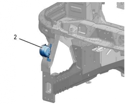

Re: Alarm unavailable
Ok, so after the ignition is switched on, in the case of an incorrect alarm system diagnostic test, the instrument panel receives a message containing the fault detected from the built-in systems interface.
The coded engine immobiliser warning lamp comes on, - on the comfort version instrument panel, a message is displayed on the dot matrix screen ("alarm not available" in the case of a failure of the alarm system, " vehicle intrusion detected" in the case of triggering of the alarm system).
So I suspect that in the case of the system on this Relay, there is a defective component, as the Alarm module can't be configured using the diagnostic tools.
Components of the System: Location of the Siren: So hard to say whether the Siren is faulty or the ECU itself
