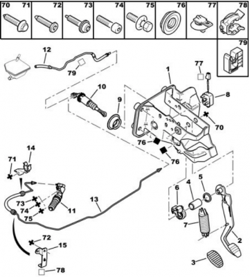

Now the clutch contact switch is part number 212778, item (8) in the diagram below:
