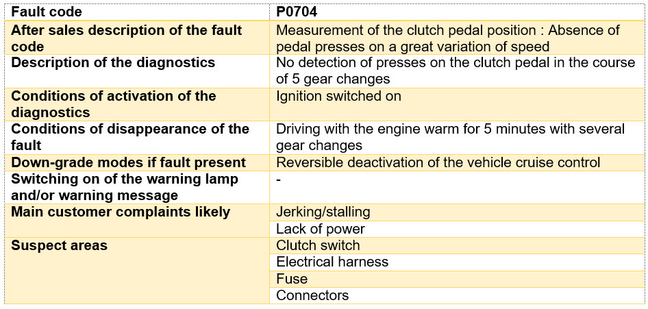

Ok, as I suspected those codes don't natively come up against this engine ECU, and the reason is probably because of the build date of the vehicle being 5th September 2002. The fuller list of Diesel fault codes started to come in about 2004 on, with far more information available.
I have managed to locate the P0704 fault and that of course relates to the clutch switch not detecting movement through gear changes when engine is warm at least after 5 minutes.
Now in light of what you have already said about it being fine at start up, getting progressively worse, that would seem to correlate:
Have a look at my table below, but you will need to click on it to zoom and and provide a clearer image.

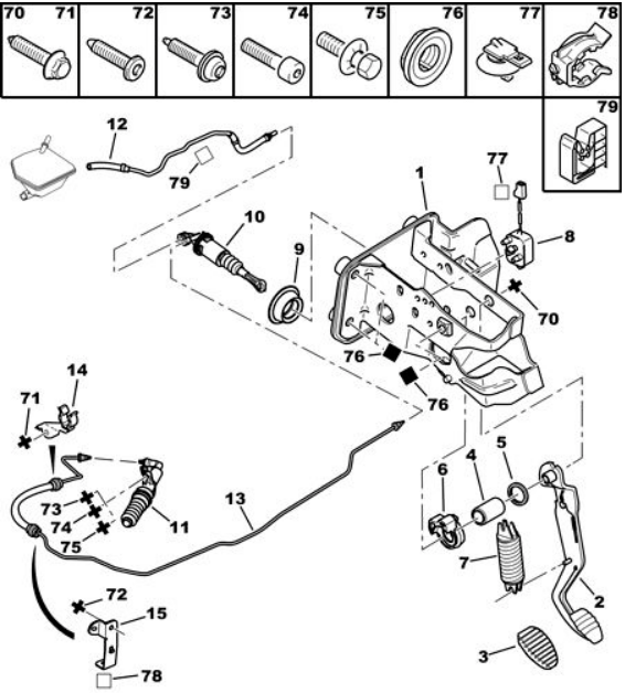

Now the clutch contact switch is part number 212778, item (8) in the diagram below:

So I can't help with the other code regarding the fuel pump as it isn't listed - generally I don't like playing 'parts darts', but it may be worth a punt for the price and it does cover the issues you described as you can see in the table.
There is one on the bay of evil for £15.99 inc. Postage here:
They are available from Peugeot brand new for £29.92 inc. VAT.
