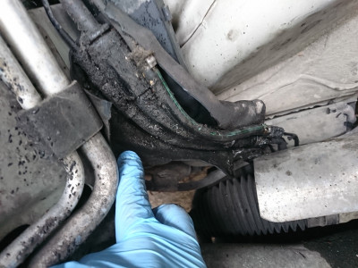

Hi all, i found leakage that i was thinking it is from brake hoses but as it tournout it is from suspension hoses. Can i replace the hoses that are on pictures by myself, or it have special technician to do it?
Another thing is oil leakage from vacuum pump. Should i put new gasket or just to put gasket sealant?
Thank you all
