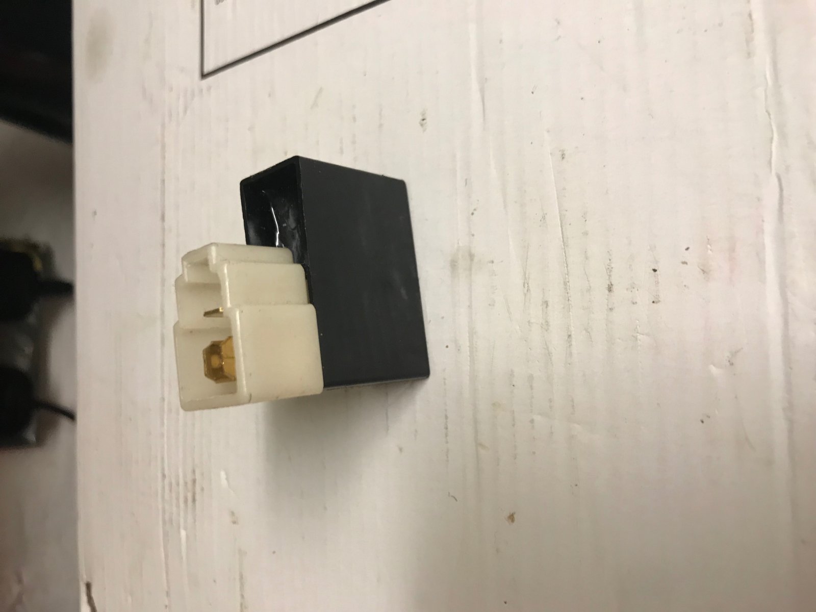

Re: Travels & travails with a C15 (& other vehicles)
Sorry if this is more like a diary, but here goes:-
Thursday (evening) - bulbs hadn't arrived (no great surprise, they weren't posted 'til Wednesday - but still with a Thurs/Fri delivery!), noted Xantia's 170 miles o/d for oil change, returned to stripping the old passenger door off the C15 (sick of the sight of it in the porch): not much left to do but couldn't remove external handle 'cos haven't worked out what you can get on the rear nutm thought access (or, at least, sight) would be better if latch came off 1st - 'cept can't shift the screws with what I've got to hand in the way of hex bits.
Friday (evening) - bulbs had arrived: opening the box they'd been sent in revealed 2 plain white,old style bulb boxes, with 45/40 on the flaps. Opened one, contained a "Ring" 60/55 halogen bulb. Not 1st quality - but not unbranded/obscure/Chinese either, so that's a +! Quickly fitted - & off down to Devon for the w/e.
Saturday (between showers) - discovered the other bulb (recently received wisdom is replace bulbs in pairs, keep good old one as spare - & when you have to fit that, buy another pair) while in an identical (anonymous) box was unbranded &, if not used, NOS; fitted it anyway, only to find the old was was also unbranded - whereas the one that had failed was one of Uncle Joe's.
Finished the relay/upgraded loom install (i.e. attached earth to battery clamp, re-made the in-line connector in +ive lead & plugged the bulbs in) - BUT nothing worked! Difficult to trace the wiring, as the loom's actually quite nicely put together in flexible convoluted tubing, especially without dismounting the relay sockets so, with mood deteriorating with the weather, decide to call it a day.
Of course, with coffee & warmth my resolve strengthened - & the more convinced I was that the problem was the component I didn't recognise/couldn't identify, which I'd never seen in this sort of set-up (with which I am very familiar) but thought must be some sort of thermal cut-out, as there are no fuses.
Sunday (won't say "this morning" in case midnight'spassed before I've finished) bright, sunny, dry (hallelujah), almost warm, i.e. much more conducive to faultfinding & fiddly jobs. 1st thing I discover is that the mainbeam side of things seems OK now, replace relay & it clicks, reconnect a headlamp, turn on mainbeam & it lights up. So it should (although I'm sure it didn't on Saturday) as that is is perfectly straightforward & logical - although there is a wire going to this cut-out (if, indeed, that's what it is) but unplugging it makes not 'ape'orth of difference. However, the dip circuit is altogether different: no wire direct from the original bulbholder to the trigger terminal on the relay but, at 1st sight, altogether too many earths - except one of the black wires goes to the "cut-out" - or would, if I hadn't unpugged it, soooooh, bridge the 2 terminals in the plug which AREN'T main beam, turn on dipped h/l's - &, voilà, terminal 85 or 86 (whichever) is live, replace relay, which clicks, reconnect headlamps - & they work!! Work very well too, as became obvious on the drive back up to London. All I have to do now is tidy-up the "cut-out" delete - AND splice a couple of fuse holders into the power lead from the battery.

Zelandeth
- Posts: 5328
- Joined: 16 Nov 2014, 23:36
- x 1607
Could your mysterious box in the circuit be a dim-dip device? Know they were everywhere in the early 90s, no idea when they stopped being fitted.
Their purpose was to ensure that dip beam was lit dimly when the side lights were turned on to improve visibility.
Oh yes dim-dip - DRL's by another name! Yup, know about those: re-configuring the 2 relays used on 2CV's so they served more useful function, i.e. stopping the lightswitch melting, replacing the the modules on XJ40's (not being clever enough to deal with their infamous dry joints) - including utilising an extra relay to use the more common single headlight ones in twin headlamp ones (which all 3 of mine were). But, I digress, this little box is an integral part of the aftermarket headlamp relay loom.
I did ask the seller about it but he didn't know (he's a salesman, not a technician) but sent me a wiring diagram (which I recognised as the the Chevy S10 one I got for the I got for the red Cherokee!!) which is for the perfectly conventional set-up and doesn't include the mystery component.
