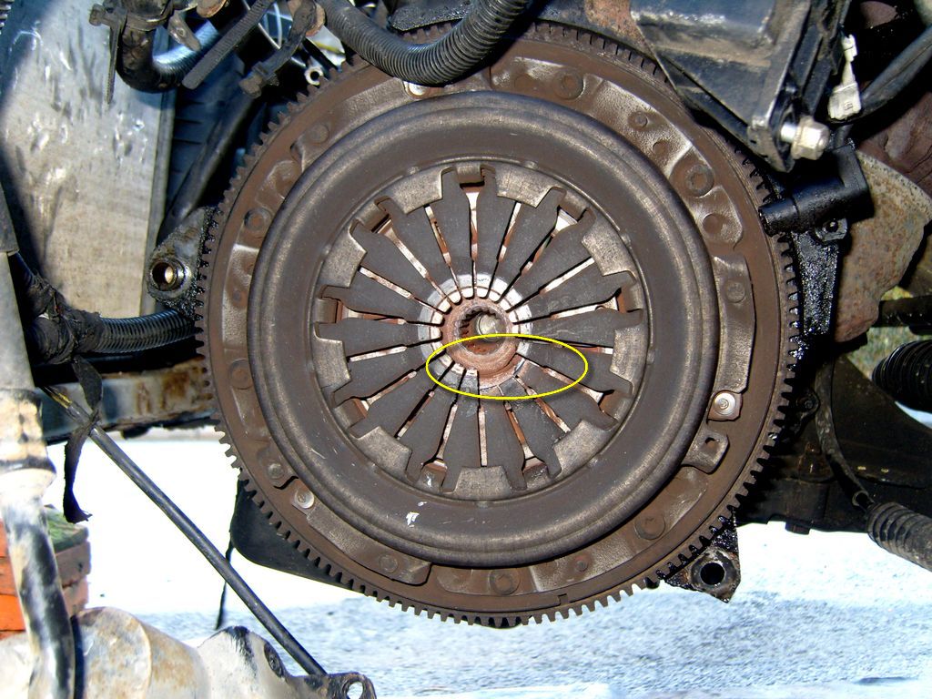

If its not the oil, it could be the clutch plate, which for me was the cause of a clutch job on my 405 a couple of years back.... The 'fingers' on the pressure plate wear and eventually snap (see pic, this is what mine looked like) causing lots of strain on the clutch cable and difficult gear changes: I found 'Reverse' went first. Coz the friction plate is unaffected, you could stick it in 4th at 20mph uphill and bury the throttle & it'd slowly struggle up without slipping.van ordinaire wrote:I feared it was the clutch - but there's no sign of slipping (& it was severly tested once or twice today). Could it really just be the cable?
I would imagine, the DW8 and the XUD being largely similar, that; just like the XUD 'box, you can take the half-circle bottom cover off the box (where it meets the engine block), 3 x 10mm head bolts on mine and have a prod about in the bottom of the bell-housing. If you find a 'finger* or two' in there* it'll point to this being your problem.
*will look a bit like the end of a feeler gauge.
NB: I suspect you realise this but a mention anyway, it is possible, thought not particularly easy; to drive without a clutch; getting started again after a full stop and changing down when going downhill are especially tricky; so defo no driving it in Dartmoor again til its sorted; one of the rare locations that I've found where a given hill can be steep, narrow AND incredibly twisty. You often get '2 out of 3' but less so all 3.
NB2: my apologies re faffing & delay with t'other. Missus needs the car locally today & tomorrow, hence having won a genny - to power the grinder - on the bay Tues, I can't get to MK to pick it up til Friday.
