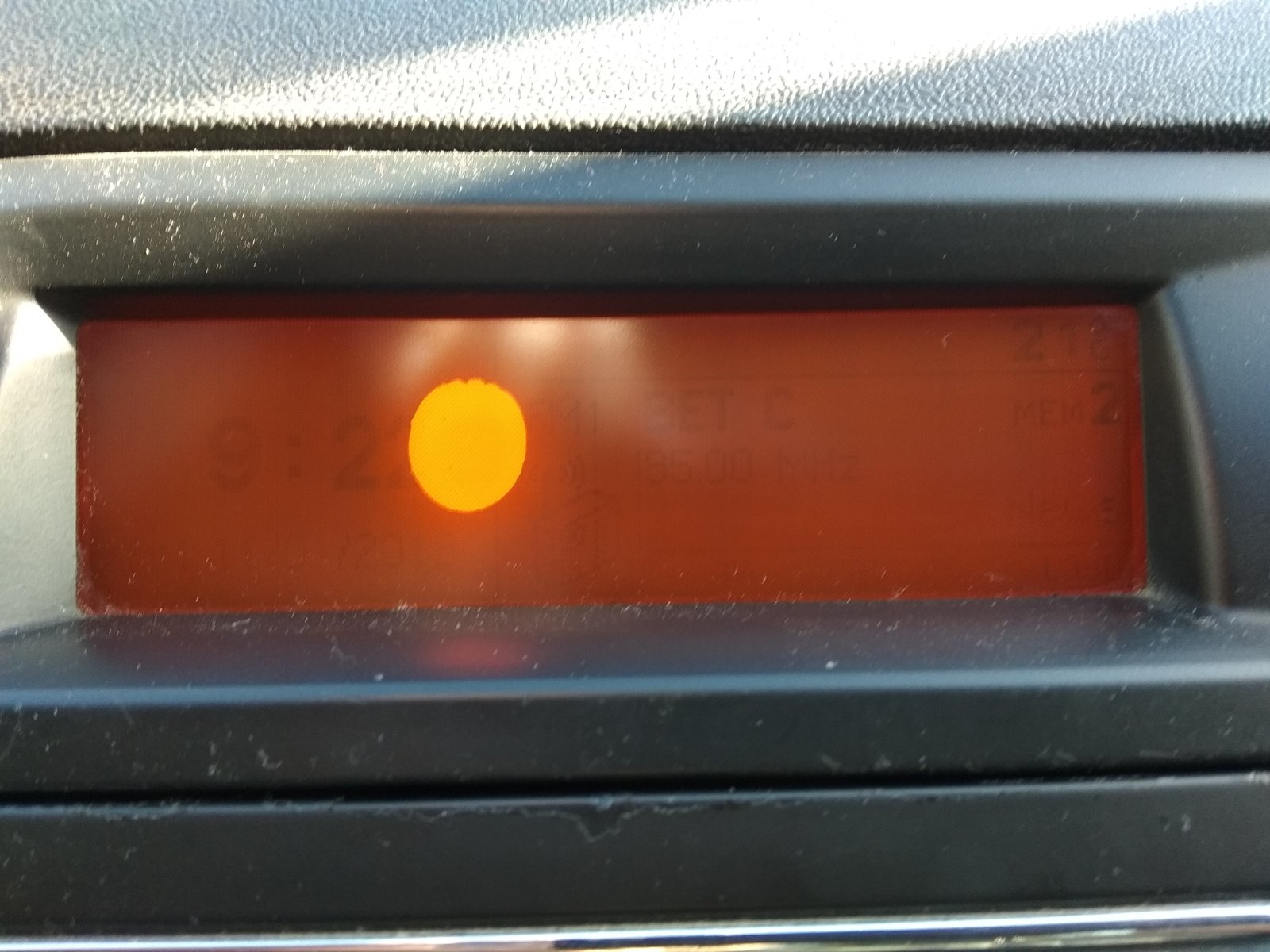

on my c5 x7 the multifunction display has a problem. there is a bright spot on the middle of it and the info is (very) hardly visible. since I have the mfd from my previous c5 mkii, I would like to know if it's compatible with the one fitted in the x7? pic of the faulty mfd attached. Thanx.

Avi - do we have the VIN of your current X7, as although the X7 with standard display uses the 'Level C' multifunction display, there are a significant number of variations, according to build date, country and options, so I would have to check. I have your old VIN for the MK II, so can do a comparison.

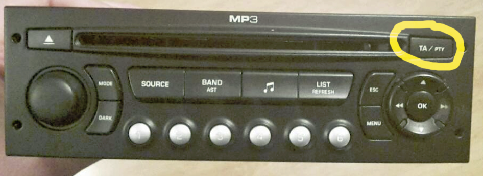

| RD4 - Has the TA/PTY | RD45 Does not |

I've checked and unfortunately, it is the RD4 , not RD45, if I got it right, so in order to be able to make it work with my cellphone, it needs to be changed to a RD45 radio.

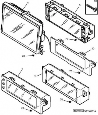

You have to understand that the electronic architecture is different on certain models from certain dates and the compatibility of the ECUs with the BSI as an example. There are of course examples where PSA will use the exact same part number for a Citroen and a Peugeot model and do list identical parts numbers. But they are NOT all the same when the part numbers are different and another reason why we have people coming back with problems afterwards as they have not used the correct display. Peugeot and Citroen also display the vehicle information differently, this is another factor and can affect the vehicle if miss-configured.
Let's take the C5 II as an example; there are 5 available screens, discounting the large colour screen in the diagram that leaves 4. Of these 4, there are 8 variations.
So what are the variations?
