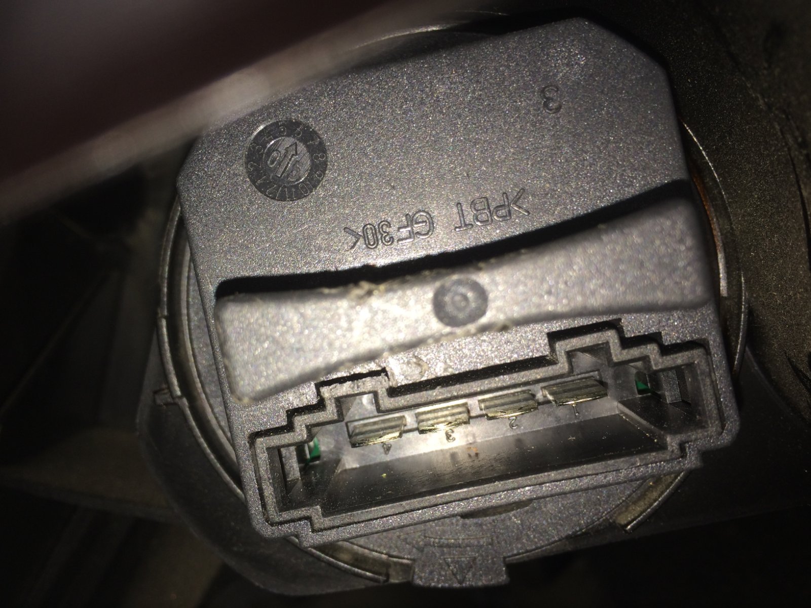

I was able to find it on the driver side, got the plug out, but it was most certainly stuck. Counter clockwise turn wouldn't get it out. I see how it's attached (or so I think) with the four plastic connections but it just did not want to rotate. I am wondering if there is something I am missing, or could it be melted/etc?
Here is a picture of it, hard to get but you can see it.
You can see I was able to turn it ever so slightly but not much more. It's hard to give it heavy force where it is located but I don't really think it should be needed, might be missing something.

If it's exactly the one in the photos then it DOES turn. A quarter turn anti-clockwise. Your problem is because of the length of time that it's been in position and things have stuck together.
Keep trying. I know it'll be more difficult for you as you have all the LHD pedals, etc in the way. Maybe you could get some kind of spanner or adjustable grips on the top to "give it the message"?
