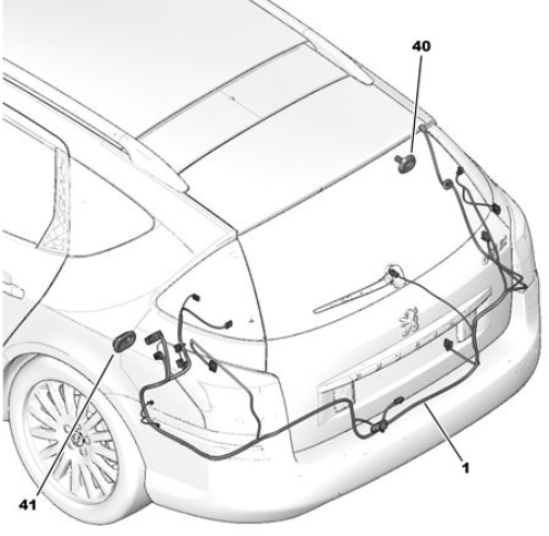

I'd start by focussing on where the wiring enters the tailgate at the top left:
This may be a weak point for wiring breaks or shorts over time as the tailgate is raised and closed. If the boot locking and unlocking is working, then the small wire to the window glass may need looking at too.

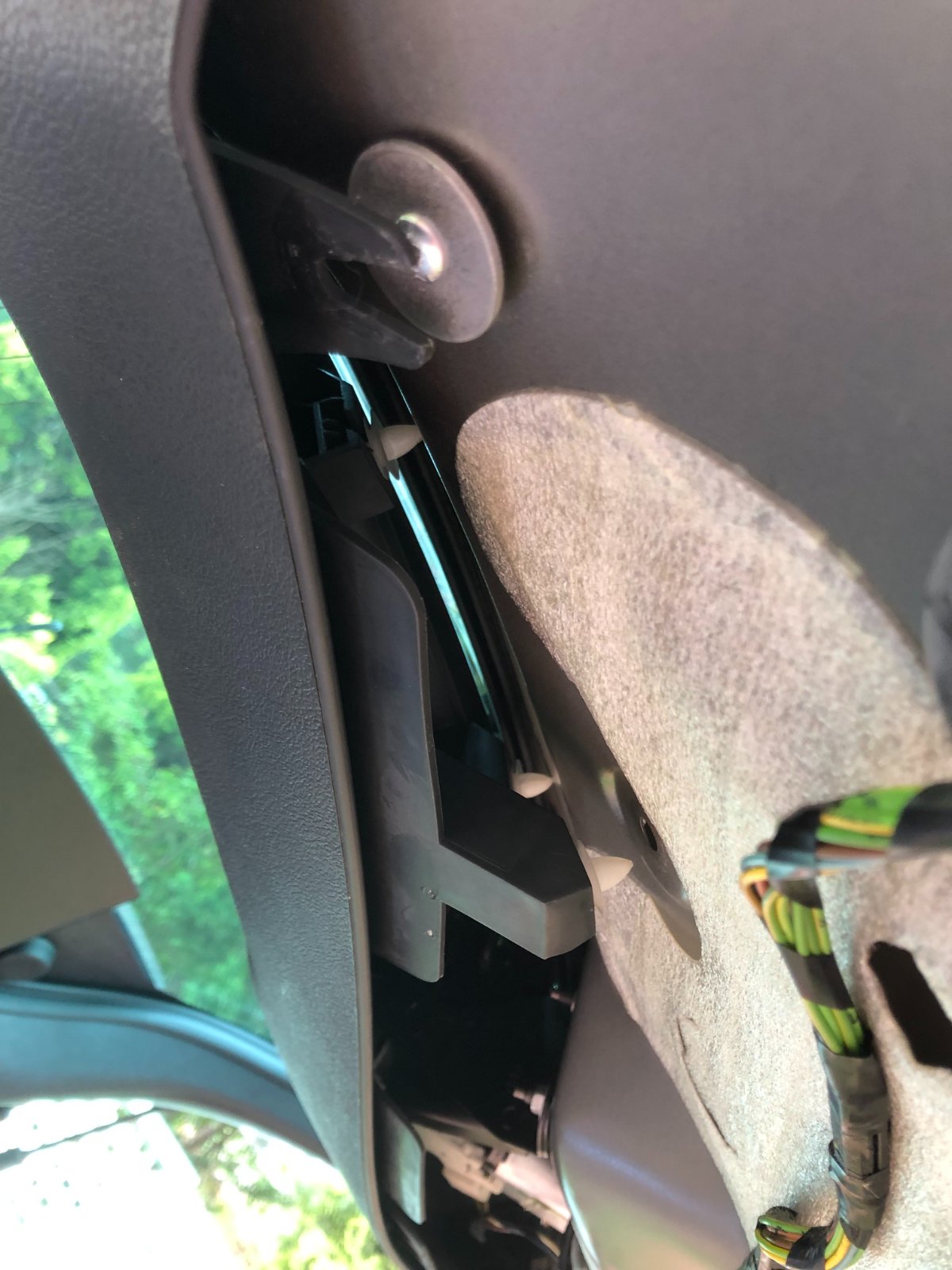

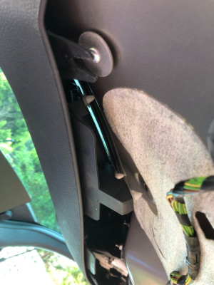

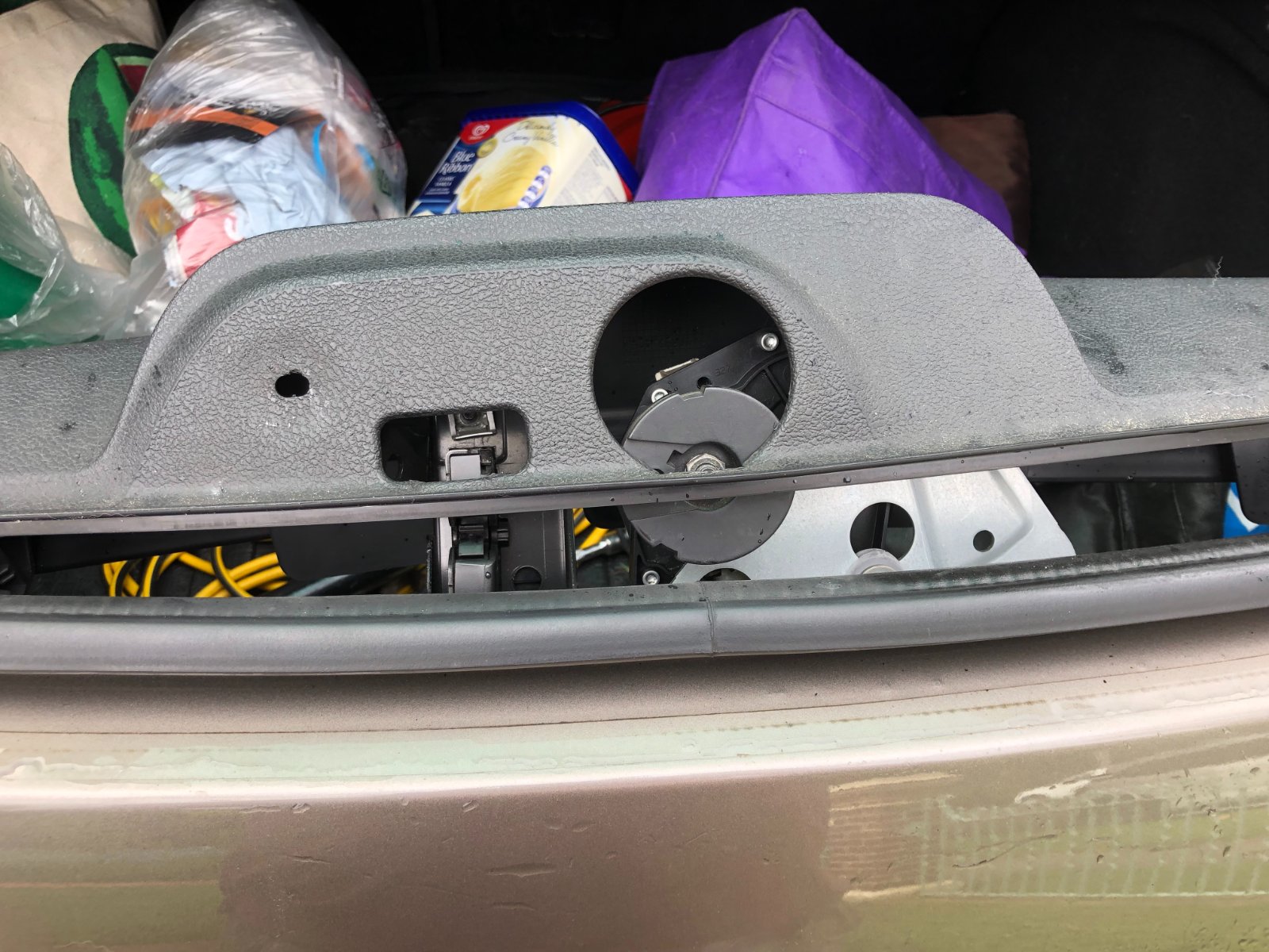

So, with my pug dog in tow, I managed to half pull the trim off with the glass tailgate closed without breaking anything
Seems you pull off the carpeted trim, ignore the riveted plastic as its just acts as a holder (I had my drill all ready to go) and the rest just pulls off, but for the part locked in by the glass tailgate itself.

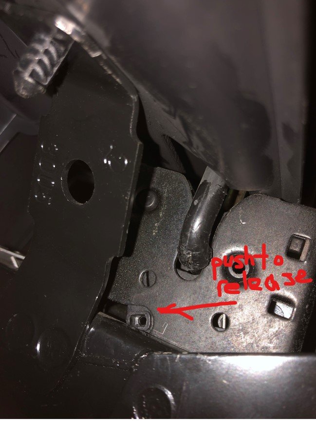

I managed to work out you can manually release the glass tailgate by pushing on the slider - see pic.

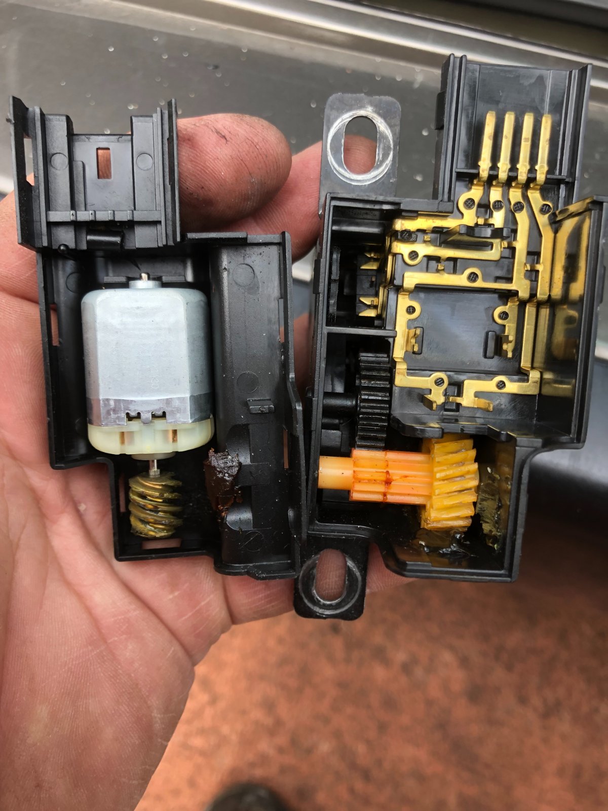

Taking the Valeo unit apart, its got a toy motor and some gearing, and I suspect something has broken off the slider as the motor spins but the gears do not move anything. Some small plastics bits fell out but no idea where they fitted - one looks like a gear engagement. I was tempted to plastic weld some sprockets on it and may do so if I get bored (and the alternative below does not fit).
Anyway, I suspect a Renault Clio Megane 8200947699 tailgate mechanism might work as it looks the same (and only AUD$35 new) so will order one and see (eg unit has only got two wires for the motor so what could go wrong)

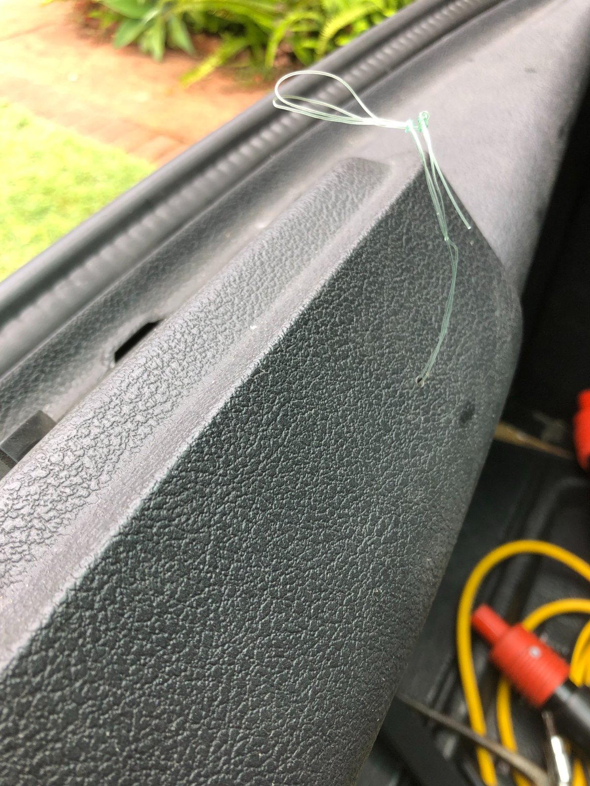

I've also put in a fishing line manual release as per pics just in case I ever need to open it (eg note small neat hole) and it works.
dodgy quick release but it works

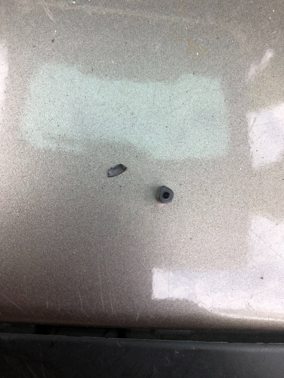

bits that fell out
bits that fell out
need to unlock the glass to get the trim off

inside the lock
inside the lock
the slider you need to push to release the glass
resist the temptation to drill these out - plastic trim will just lift over them
