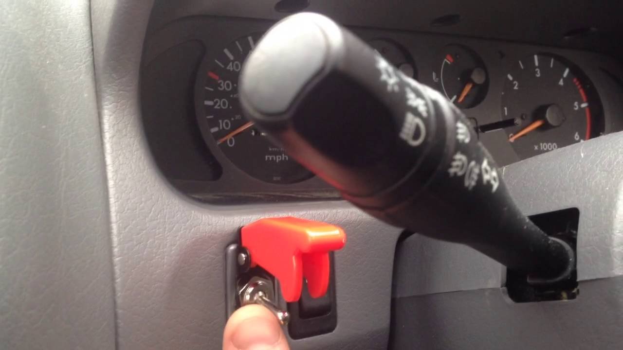

In related news: I took my C5 out for a run today after leaving it parked up for the last month. Naturally the blower didn't start up and I had to run through the "process". Only takes me 5 minutes (with absolutely NO need to remove the glovebox or lid) nowadays and then it was up and running again.
- x 1746
Re: C5 X7 2008 Blower Control Module
You must be only a whisker away from a handy "Blower: Push to Start " extra button on the dash!
- x 6946
God forbid if I ever had one of those! A nice Key will do thanks.
- Posts: 9421
- x 1941
Huh? Push to start the heater fan blower not the car Marc. And yes, its appearance is perilously close.

When I took out the module it was getting hot (it means that the current was flowing by) so I added a wire pushed in with the black one (also wrapped both together with electric tape) ended with the WAGO 222(isolation) on the other end, hidden under the cover (right leg passenger ankle). In case the motor seizes again It will be few second to open the cover(one screw only) and short it to the GND.
But the button looks cool, 007 like rocket launcher.
Now when I know where to module is located - no need to take out the glove box - however to do all test I did it was necessary. A lot of learning.
Thanks for help, I hope my posts help other too.

The idea of a 'kick-start switch' was meant tongue-in-cheek, of course.
The decent solution is to free up and lubricate the partially seized motor, or the problem will only get worse.
Interesting that the module has a soft-start, which, although good in itself, is just what you don't want if you're hoping to free-off a sticky motor.
I don't think it's good practice to regularly start any of these (or many other) motors on full speed with full supply voltage on tap: the initial current in-rush is huge. One practical tip is not to leave fan controls on full speed, and then start the engine! Running current at maximum speed for some of these blower motors can be 20-25A, and momentary starting current can be several times that.
