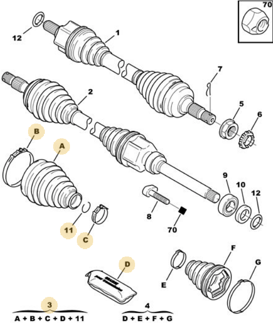

- Item (4) Kit on diagram (Final Drive Dimension Side: Part No: 3287A5 £43.46 inc. VAT UK.
- Item (3) on the diagram (Wheel Side) Part No: 329334 £37.79 inc. VAT UK
