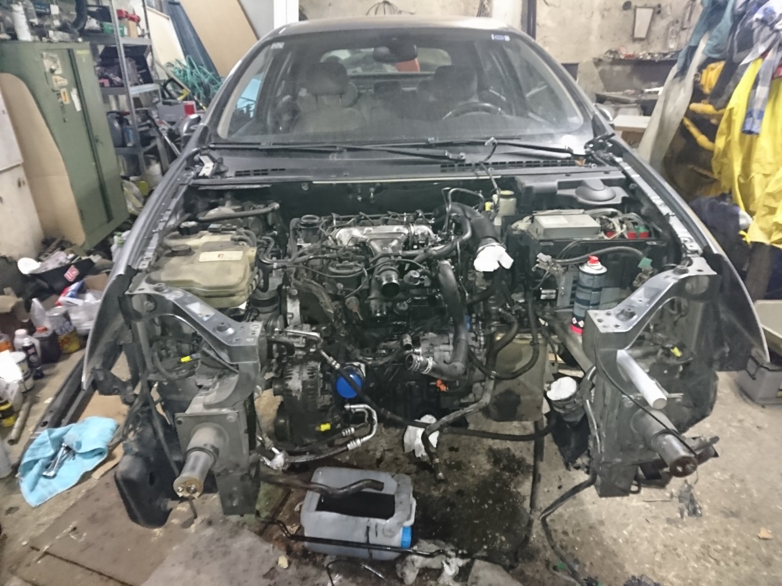

drAnte
- Posts: 15
- Joined: 01 Dec 2018, 20:59
Re: Citroën c5 2004 automatic transmision
I have few questions. Should i remove all turbo hoses?
Should i disconnect wires and cables from engine or from source?
What to do with this hose in front of the car, looks like it goes from coolant box.
citroenxm
- Fallen Hero
- Posts: 8061
- Joined: 30 Dec 2004, 23:10
- x 70
Hoses at the front yes take front end off.. Hose under the car to the turbo I didn't bother.. If your worried at all about splitting or breaking a hose then take it off to be safe.. I removed cables from source but my unit wasn't going back in.
A very sad...
1994 XM 2.1 d auto
A very sad...
1994 XM 2.1 d auto
