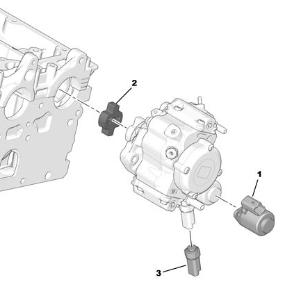

Does this model of C5 have a pressure regulator? If it does, I wonder if that could be at fault. I remember reading of issues with the HDi engine that have been caused by the regulator getting blocked.
- x 6945
Re: c5 2009 2.0 hdi
Yes it does James, but another expensive part at around £145 just for the sensor at the dealer and similar prices for the Delphi unit aftermarket - so another reason that the diagnosis needs to be accurate to be honest.
Item (1)
Item (1)
