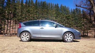

The Charcoal/blue metallic one was my first VTS. Got her at 72000 km and lost her at 140xxxkm.
The rear silencer wasn't any performance type silencer, rather just an average replacement unit at an exhaust shop.

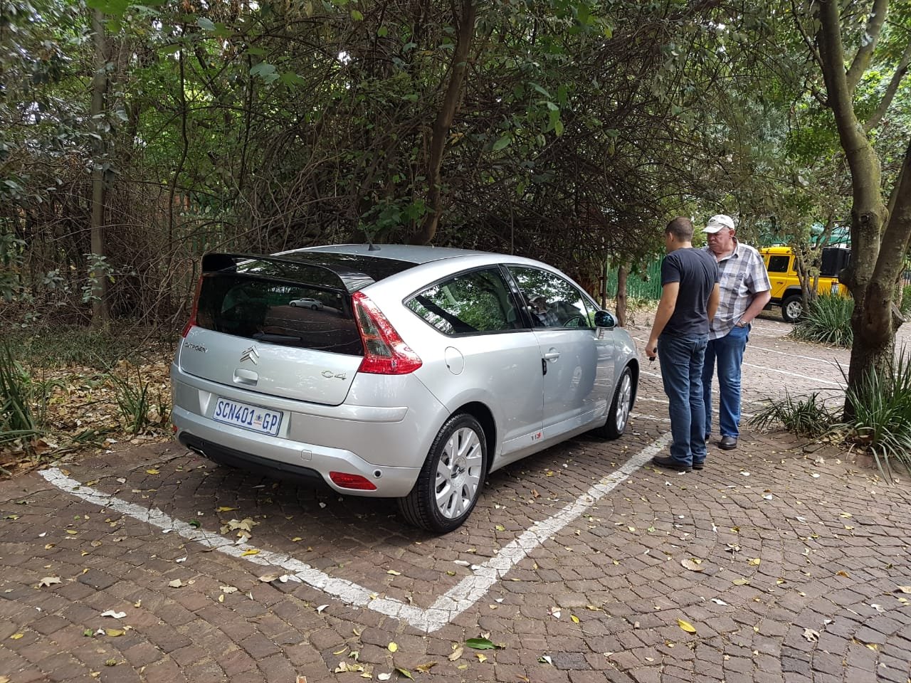

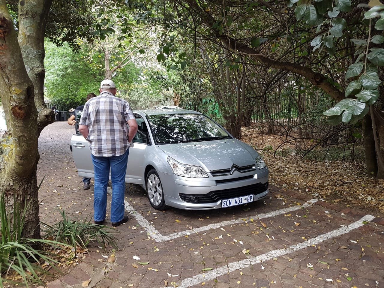

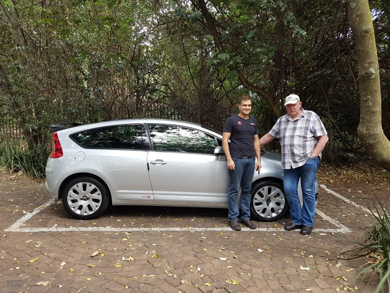

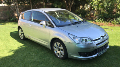

The metallic silver VTS is what I have now. with 61500km on the clock. even got the standard rear silencer still intact. hope it lasts as I don't think I'd get one again....
My silver VTS needs the conversion kit for the Aircon flap motor. Unavailable in South Africa and got a very very snotty response from a Local Citroen peugeot garage, utterly pathetic service. Shows again why I just import all the spares I need....

I really do like the rear of those C4s - a nice bit of design there - was that rear spoiler OEM or an aftermarket addition Corne?

Hi Marc
In South Africa the 2.0 16 v 180 VTS came standard with the spoiler, one of the distinction on the VTS apart from the tailpipe. The VTR coupe never had the spoiler as an option so atleast for our market it was very unique
