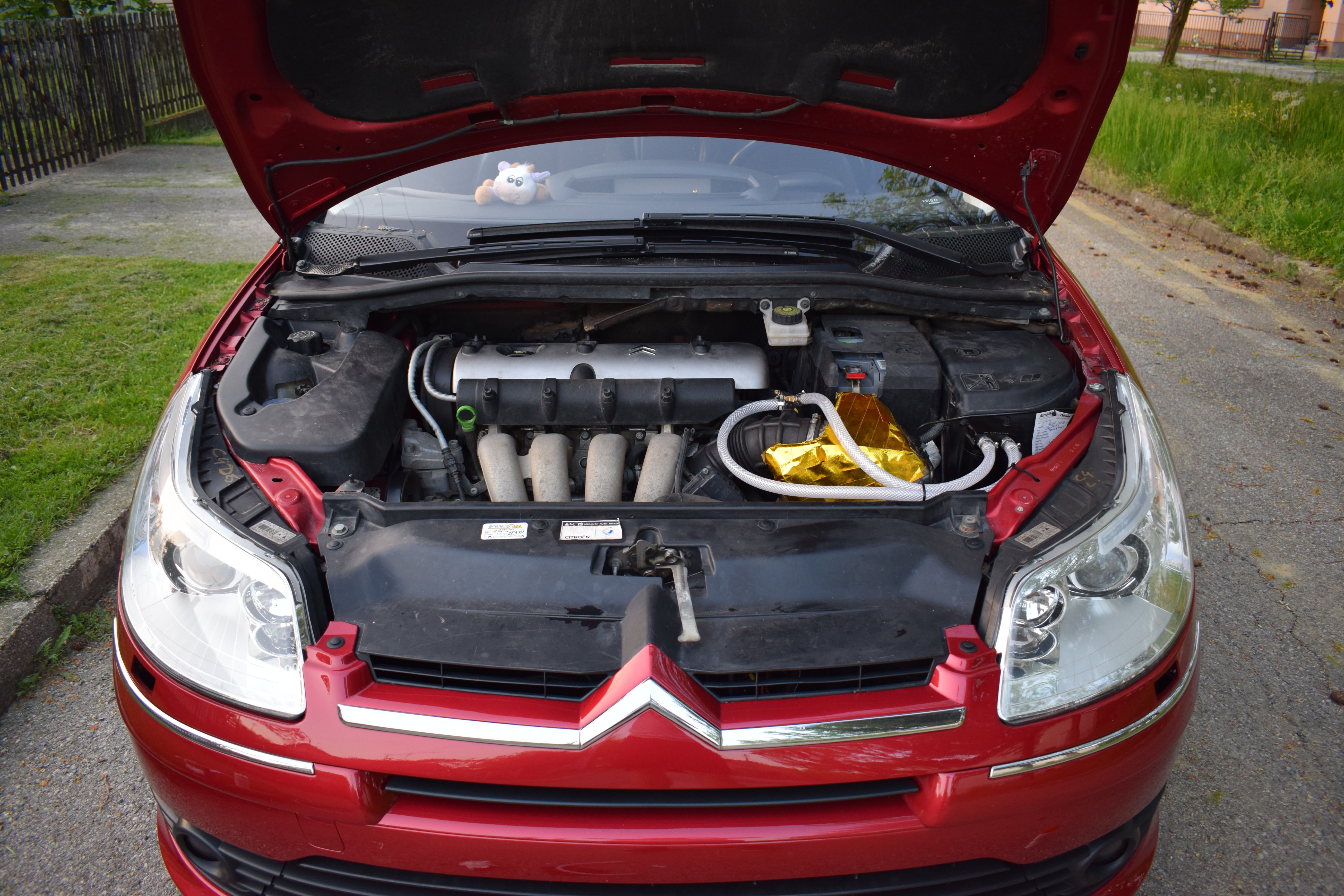

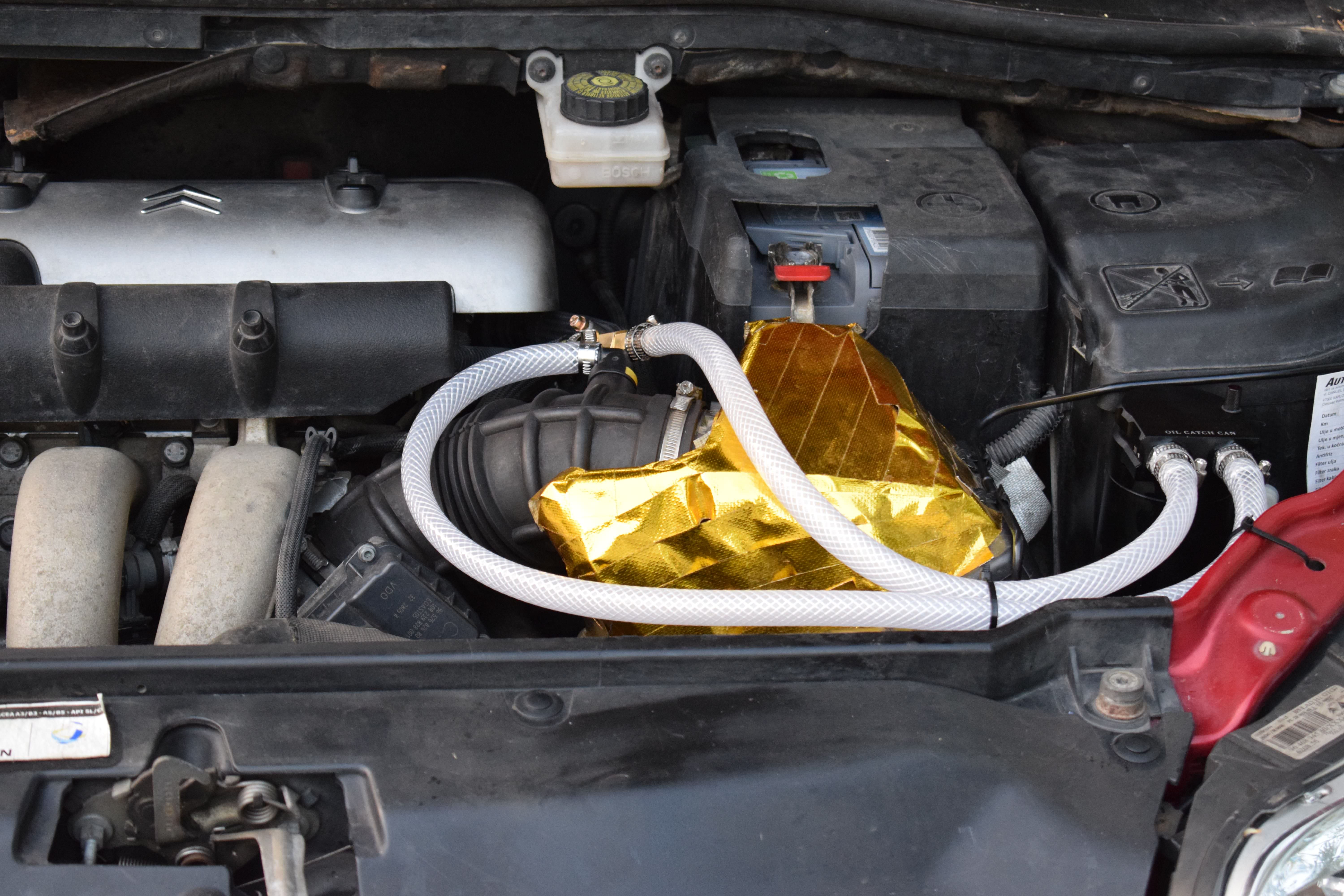

Few updates on the VTS.
Oil catch can and aluminium foot rest. Hoping I'll be able to replace throttle aluminium, too.

Very nice couple of cars. What is the advantage of the oil catch can?
Cutac
Posts: 348
Joined: 28 Aug 2016, 19:36
x 20
Re: C4 brothers
Unread post by Cutac »
Thanks :)
There's no more oil in an intake tube, thus throttle plate isn't getting dirty and clogged.
But still, engine is in good enough shape that there's barely any oil in the can. It's just an oil film inside it and the inlet can hose is just a bit brown.

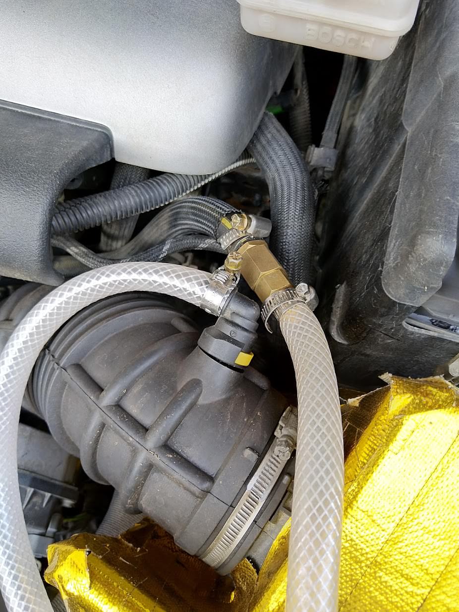

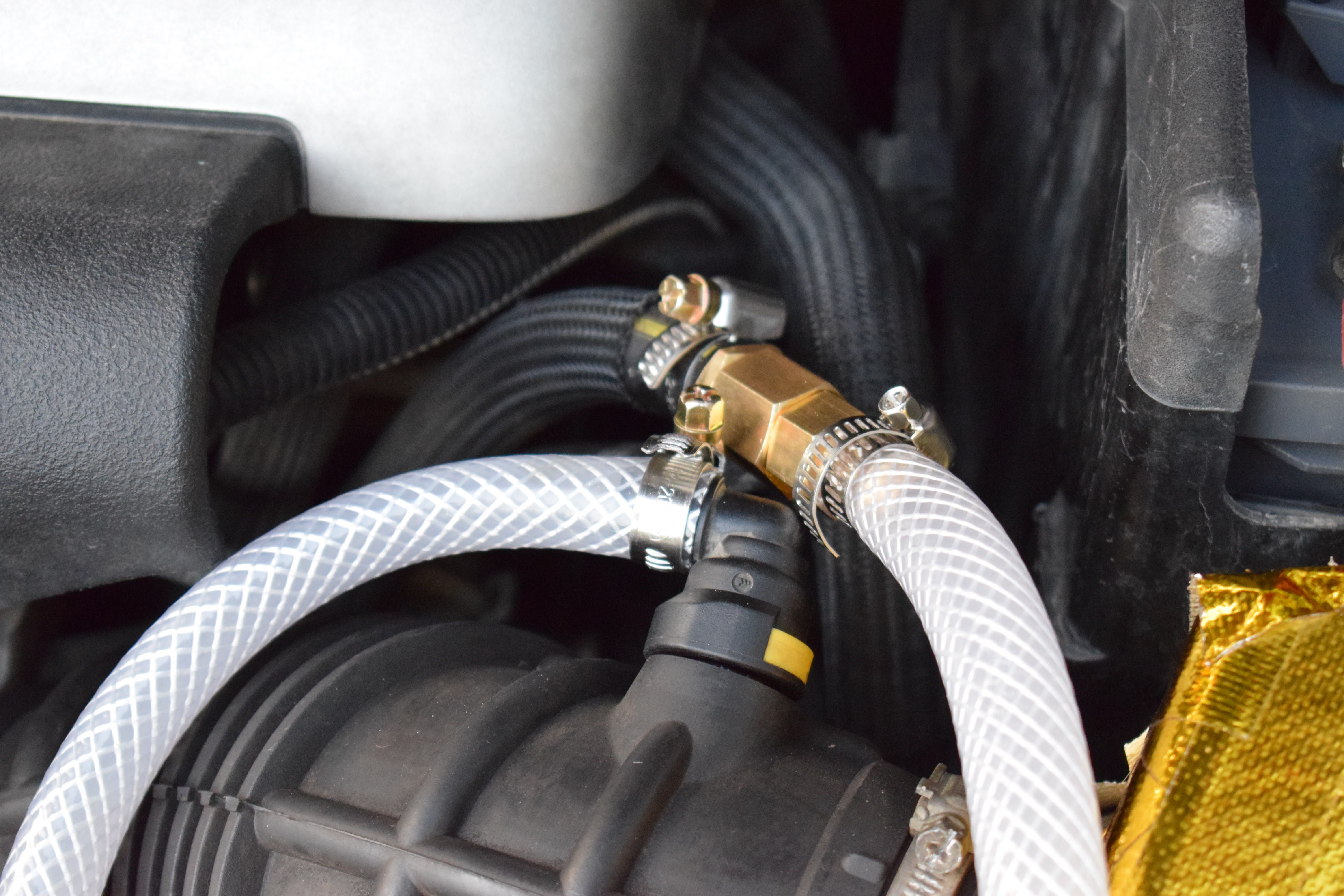

Sorry it took me this long. Here's a photo of OCC pipes. The brown is Engine-OCC, the white is OCC-Intake. Brown was white as the white is.
