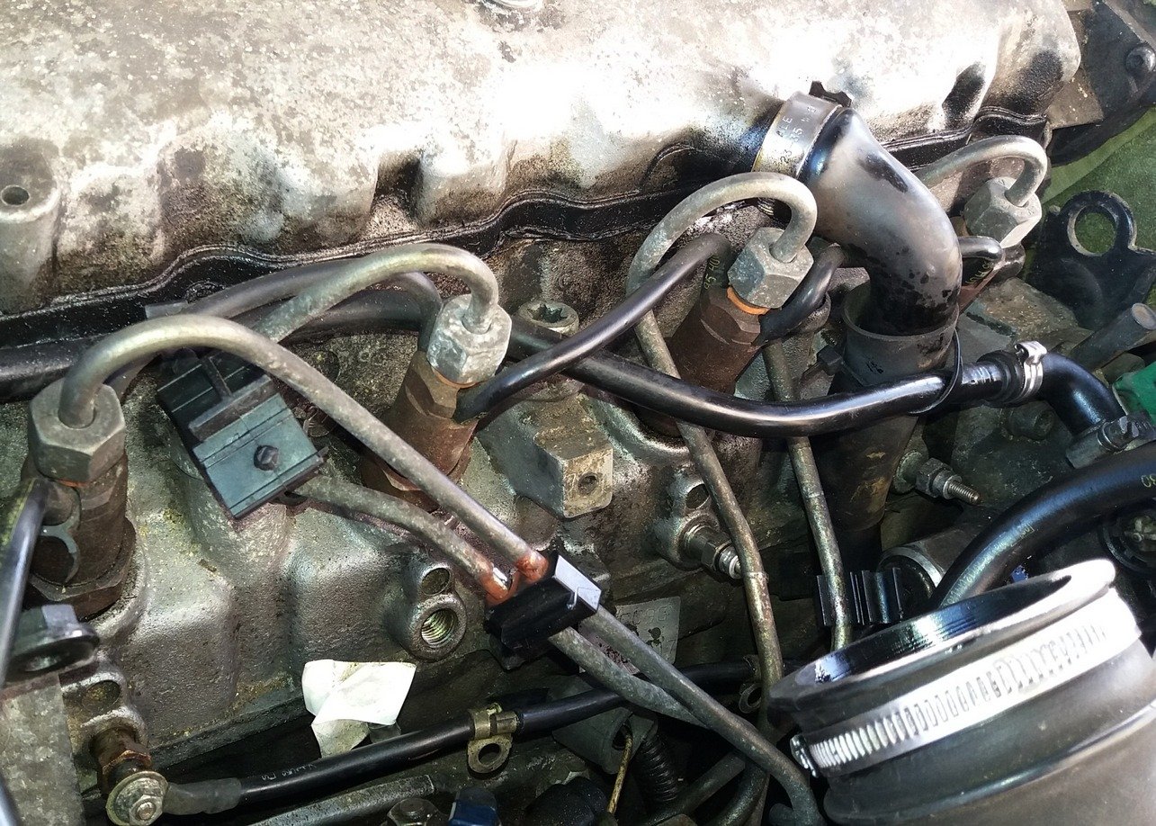

Re: No start please Help
Yes, more than likely the feed wire has come off which powers the entire rail. Plug 2* should have the terminal for the Glowplug rail and a second connector on it, which is the feed from the Relay (taped white in my photo).Gus306 wrote: 17 Dec 2018, 22:12 i have left the little 8 ml nut off of the second plug, do you think this could be the problem?
Done my own Glowplugs just today, oddly enough.
*Cylinder No. 3. Contrary to logic, you count right to left, so No.4 is at the CamBelt end
NB: I was surprised to note a tightening torque for these of just 15-20Nm, not very tight at all... and delighted that they all came undone no problem at all, after a week's daily Plus-Gasing and running up to temp first.
