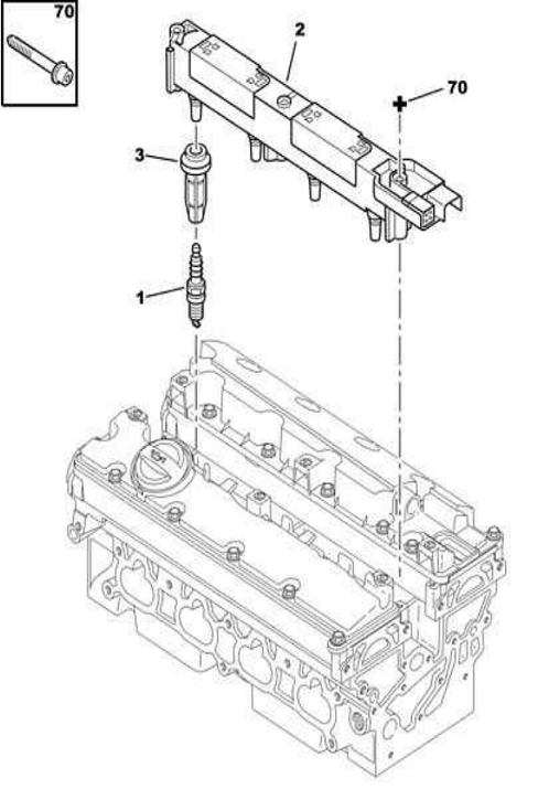

One more thing for today, the tubes that the plugs are in, are the tubes pressed into the head or do the plugs hold them in place please? Manual not too clear on that at all. One plug ht connection has an oily end, the tube may have oil in it perhaps?? will use a mirror to look see before we remove the plugs for checking.

The plugs can be seen below - item 3 are the extensions.
I have no idea regarding hex sizes though for these, but would expect them to be pretty standard, (but don't quote me on that)!

WhilsT I have the car i intend to measure the coil pack resistances and find out via the dmm if the window and visible track in the middle of the coil pack is a 12v test point.

We dont have a full service history for this car which has now just past 100k miles. I suspect it may have had a cam belt failure in the past as the main earth connection of the gearbox has not been fitted correctly, its cocked over, and, the lambda semsor lead in that area is dangling down and getting tangled wioth the gear selection stuff in that area. I thing the sensor wire is all ok but need to check and cable tie up out of the way.
The rear cam housing has been off i think as there is black sealer between it and the head.
I will get a mirror down that area and have a good look, also down the plug metal "tubes" as the no1 cylinder plug ( g/box end ) rubber foot has oil on it. It may be full of oil??

Ignition System
Reference | Component | make | Reference | Remarks |
37 | Sparking plugs | SAGEM | RFN52HZ | Electrode gap : 1 mm |
37 | Sparking plugs | BOSCH | FR8LME | Tightening torque : 2,5 daNm |
36 | Ignition coil | SAGEM | BBC2.2ND.E 2 526 118 | 4-way black connector Twin static type ignition |
