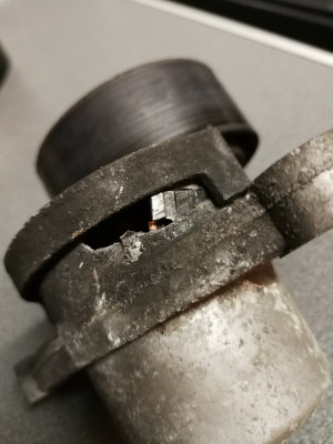

UPDATE
I have installed 2 new belt tensioners and belt. And... I may have found the cause of my issues!
As you can see from the photo it looks as if the secondary sprung roller has blown up at some point, This would explain the lack of full tension on the belt thus making the upper tensioner bounce and lose purchase on the belt when the stop/start system tried to turn over the engine.
After a test drive, ALL IS WELL!! If not better, As you can imagine not having full tension on the belt would have affected the efficiency of the AC, alternator and battery.
Thanks all for you help and advice.
- x 6947
Re: Start/Stop Issue Advise needed, Belt Tension?
Well done and will be useful for others in future experiencing the same issue.
- x 1746
Good work in tracking that down. As described above, these tensioners will have a hard life as they have to cope with both normal and cranking belt directions/tensions.
