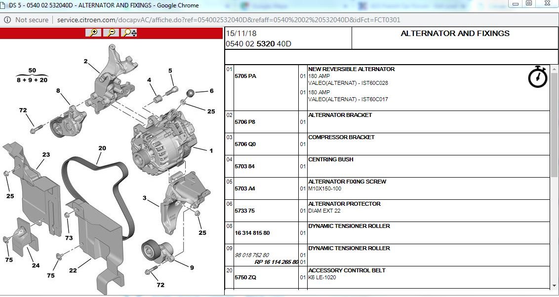

I agree that it sounds like the belt is slipping when the alt tries to restart the engine. If you can get someone else to sit in the driver's seat you should be able to confirm this visually - just make sure it doesn't run you over!!
Here's the diagram for the alt belt. Interesting that there are 2 tensioners. I would replace the belt first, and see where that gets you; only moving to the tensioners if it's still slipping.
Oddly they are completely different prices!

Thanks for the screenshot Leslie but it doesn't explain why that method was chosen over the HD starter motor. Anyway, back to the topic.

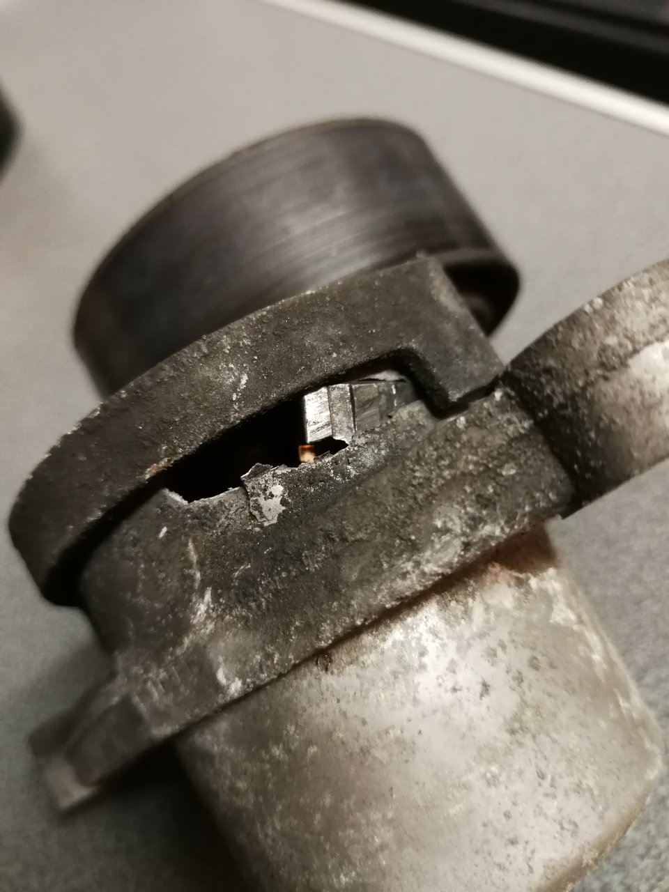

I have installed 2 new belt tensioners and belt. And... I may have found the cause of my issues!
As you can see from the photo it looks as if the secondary sprung roller has blown up at some point, This would explain the lack of full tension on the belt thus making the upper tensioner bounce and lose purchase on the belt when the stop/start system tried to turn over the engine.
After a test drive, ALL IS WELL!! If not better, As you can imagine not having full tension on the belt would have affected the efficiency of the AC, alternator and battery.
