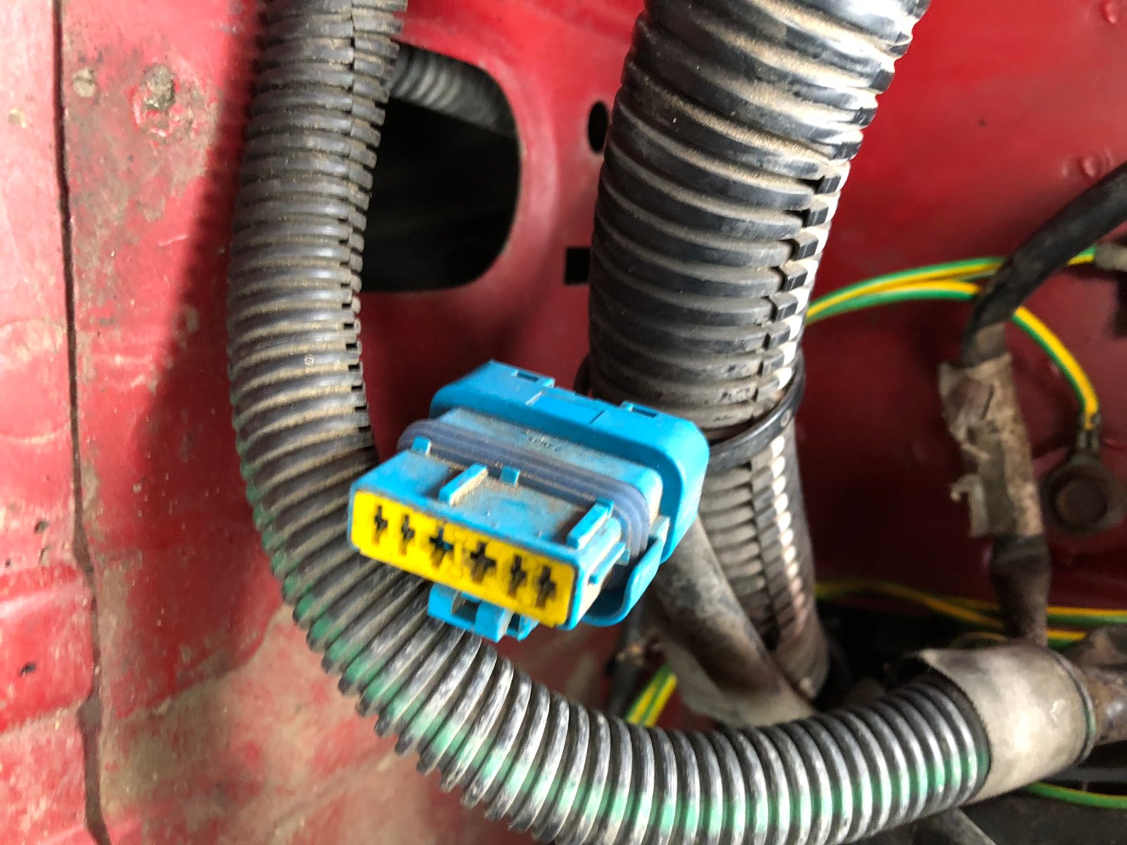

I found these boxes, may someone tell me what are they for? The photos of them are attached in this post.
I also checked that I have the connector for diagnosis next to the steering wheel. But I also found another connector which looks like it was for other kind of diagnosis as well? May someone check it on the photo? It was near left light bulb.

The first picture is the Glow Plug Relay.
The second looks like a throttle position sensor
Not sure about the third one

Re: Berlingo I 1,9D M WJY 2002 - electrical issue
Could the 3rd one be an accident shock sensor, that's not fitted, I remember seeing something similar next to the LH susp in the engine bay on the 406?
An accident shock sensor? I will try to find more about that.. thank you!
If there's nothing near it, and you haven't changed anything, I would ignore it.
That’s an interesting suggestion Pete.
@ TessG: As Pete says, ignore it if it’s been taped up out the way. Some cars utilise the same wiring harness across a range of models, to allow for optional equipment or features. So is probably for something that isnt fitted.
Don't think the first one is the glowplug relay, far to many pins in the plug. looks like a 15 pin 'double' relay to me, it will be for supplying power to the ECU & 12v sensors.
not sure about the 3rd one but its definitely not for an inertia/impact sensor, they are 3 way plugs. it will be for something not fitted to the car if there is nothing nearby it fits. any codes printed on the wires will give a clue to what its for.
I think you're right Wheeler, also the red locking lever should be pressed in, it looks like it's in the 'unlock' position from the photo. On my 406 the locking mechanism had broken and from time to time it vibrated loose and the engine would turn but not fire. I found the problem when I connected PP2000 and it wouldn't see the car. Started wiggling things and a heard several clicks.
The locking tab looks fully home to me, if you look at the opposite side from the big red bit you should be able to see a small hole that you can put a little split pin etc in to stop it coming back out.
