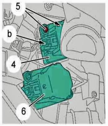

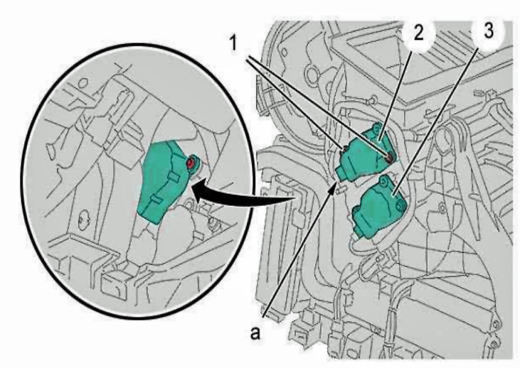

Mike, initial thoughts suggest the air distribution motors. Either the motors are faulty (unlikely) or the plastic gears have worn preventing the opening or closing of the distribution flaps.
This would be likely if the air seems to be stuck flowing from the same position.
I would open all the dash vents fully for testing, and put the blower control on a high speed, then sequentially direct the air on both sides (if you have dual climate control) to the top, centre and then floor, waiting a little while in between to see if the motors whirr into action and that the air does change distribution.
If poss., and you have dual climate, check left and right vents at each position change to see if you can isolate if it is the left or right hand motor (s) which are faulty.
It is a known issue where these plastic gearings can become worn or snap. There are fixing kits to replace these gears, but a fiddle of a job to get them out to do the repair.
Hopefully the above will help to determine if this is the likely suspect or not. So it is possible that it is either 4 or 2 in the table below:
| Number 4 on the Right Hand Side is Air Distribution 6 is the Air Mixer Motor. | Number 2 on the Left Hand Side is Air Distribution Number 3 is the Air Mixer Motor |
