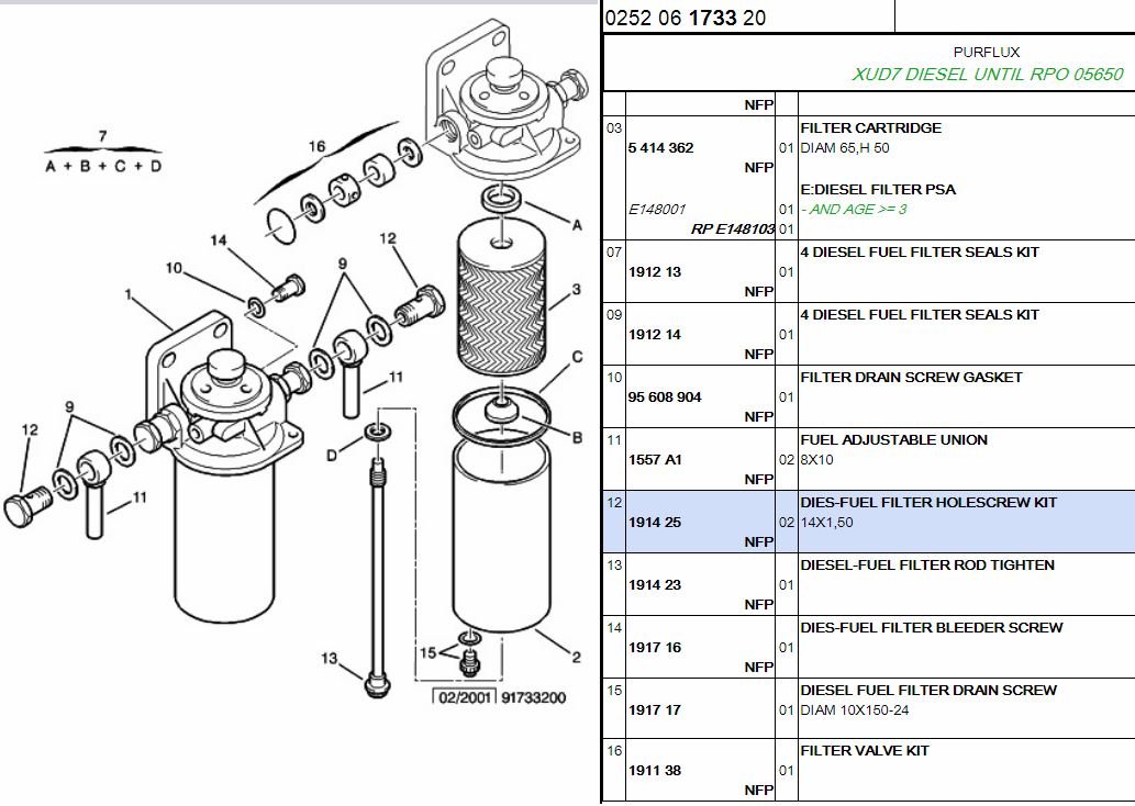

There are a good few folk here who know the C15D in detail, so I tried my best on a general check-through, which you've obviously done much of already.
If your fuel filter is like this one, a Purflux (it may not be)...
...the banjo bolts (input and output) are ##12, and the micro-filter/non-return valve is under one of them at #16.
Click on diagram to enlarge.
