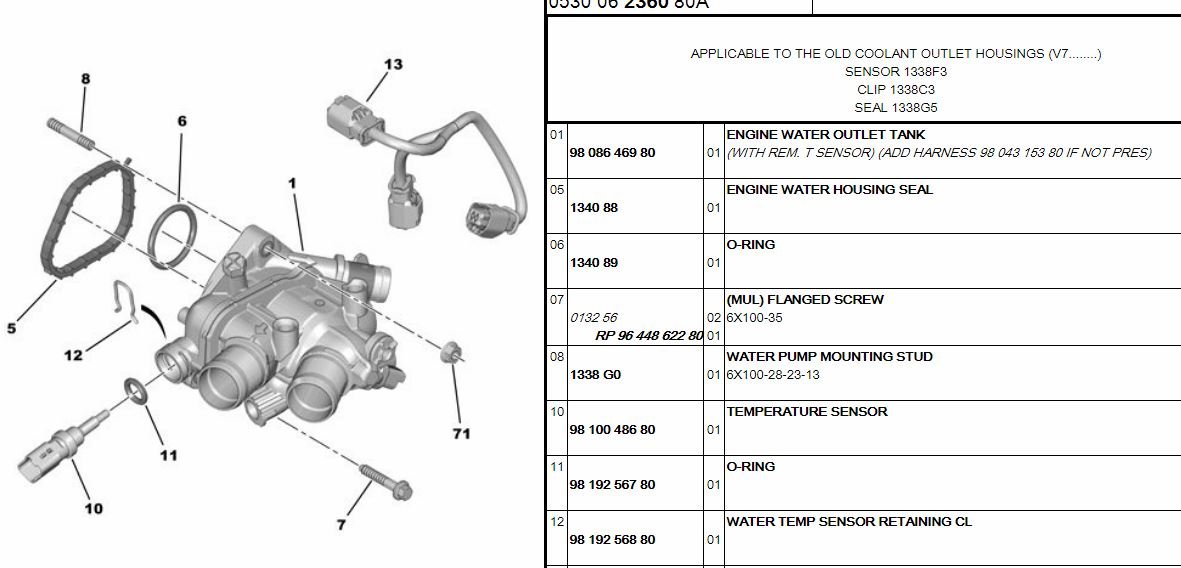

Is this the one you were looking at (item #1)?
It's the one that comes up for your VIN...
I see there is a note at the top of that page about an old housing. Unsure about that.

Yes, that's the one. That's the code I've brought to the shop and accordingly was given a thermostat.

Figured it out!
I've got(on the engine) an original thermostat which is an old design.
I've bought a new design ts which has different connectors.
To fit the new ts, I need "98 043 153 80" cable.
I'll buy the cable and see if it works. If it does, I'll take pictures of everything and make a guide

I see you figured it now - but there was a modification done and a technical bulletin on it - hence the need for the harness if fitting the old type. But don't forget the clip and the seal too:

The clip and seal should be already present on the new thermostat.

Ok, they just list those along with the old sensor which gave me the impression that they are separately ordered.

I have it already.
I've got this and now I need this '98 043 153 80'.
