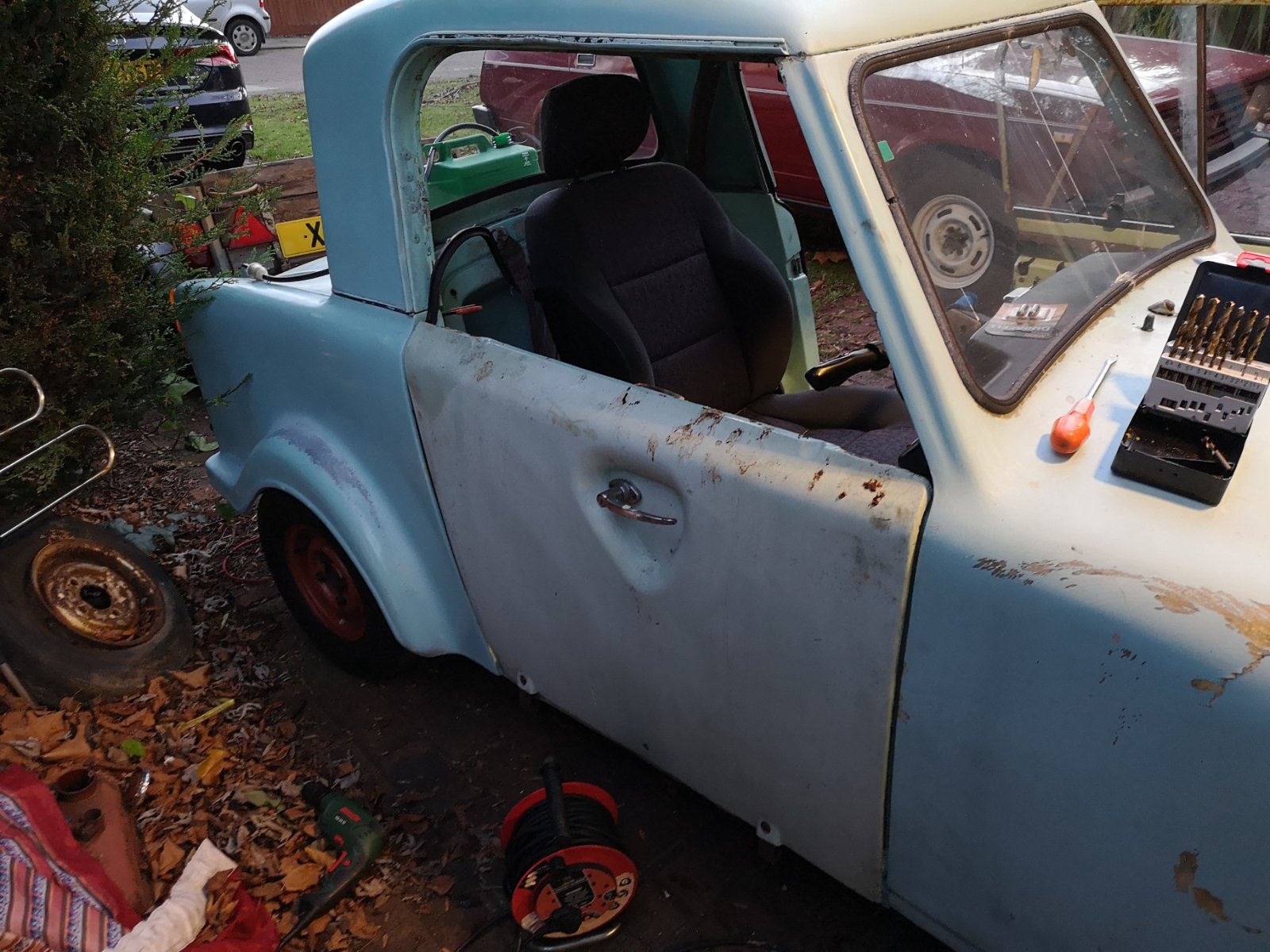

Today this happened...
Have made one good door out of two knackered ones. While the one previously on there was superficially in better shape, the lock mechanism was irreversibly seized it seemed and the frame had been damaged in several places historically by someone trying to free it off. While this door looks worse, it's structurally fine and the locks work as they should. The window frame on this one however was shot so I had to transfer that over from the old door.
Simple enough task...aside from the small detail in that I had to drill out every single screw involved on both doors. Took forever.
Need to pick up some suitable fasteners tomorrow then will hopefully get the glass refitted...then to do the same thing for the other side. While the locks on that door are fine it's got several holes in and more annoyingly the skin has separated from the frame so the whole thing is floppy. As such it flexes when you open it and wedges itself on the runner... really annoying. The external door handle is missing too. So I suspect tomorrow will involve further drilling out a thousand screws...

In a way it's a good thing I've had to take the doors totally apart, as the gap under the window runners is where one of the worst water ingress points was, and having them apart gives the opportunity to apply a suitable sealant when reassembling it. Looks like there was some form of putty in there originally, but it's long since turned to powder.
Also lets me rust proof the bits where the frame fastens to the door, which is usually hidden under the window runner channel and is inaccessible.

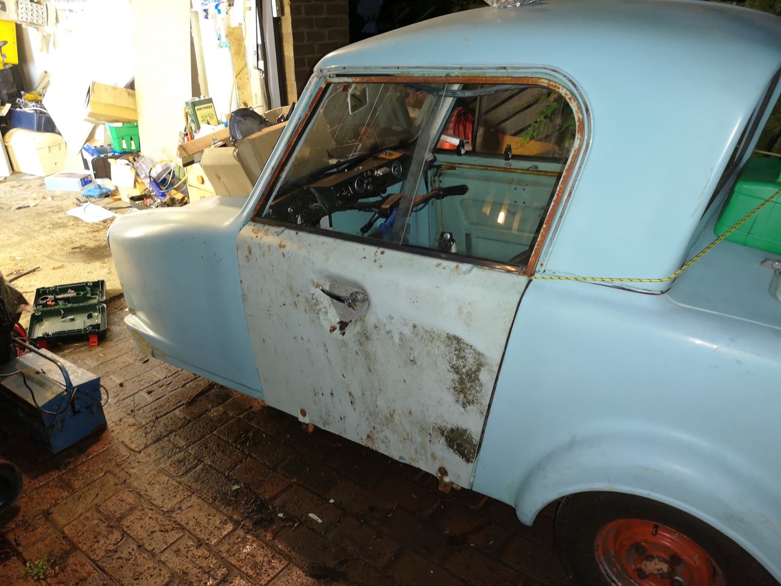

Today I got the window and such stripped off the offside door from the Invacar (after drilling out another 8274662819 screws) and put the good door base on the car.
I'll hopefully get the window frame and glass reinstalled tomorrow. I'm slightly staggered by the whole concept of actually having two functional doors on the thing.

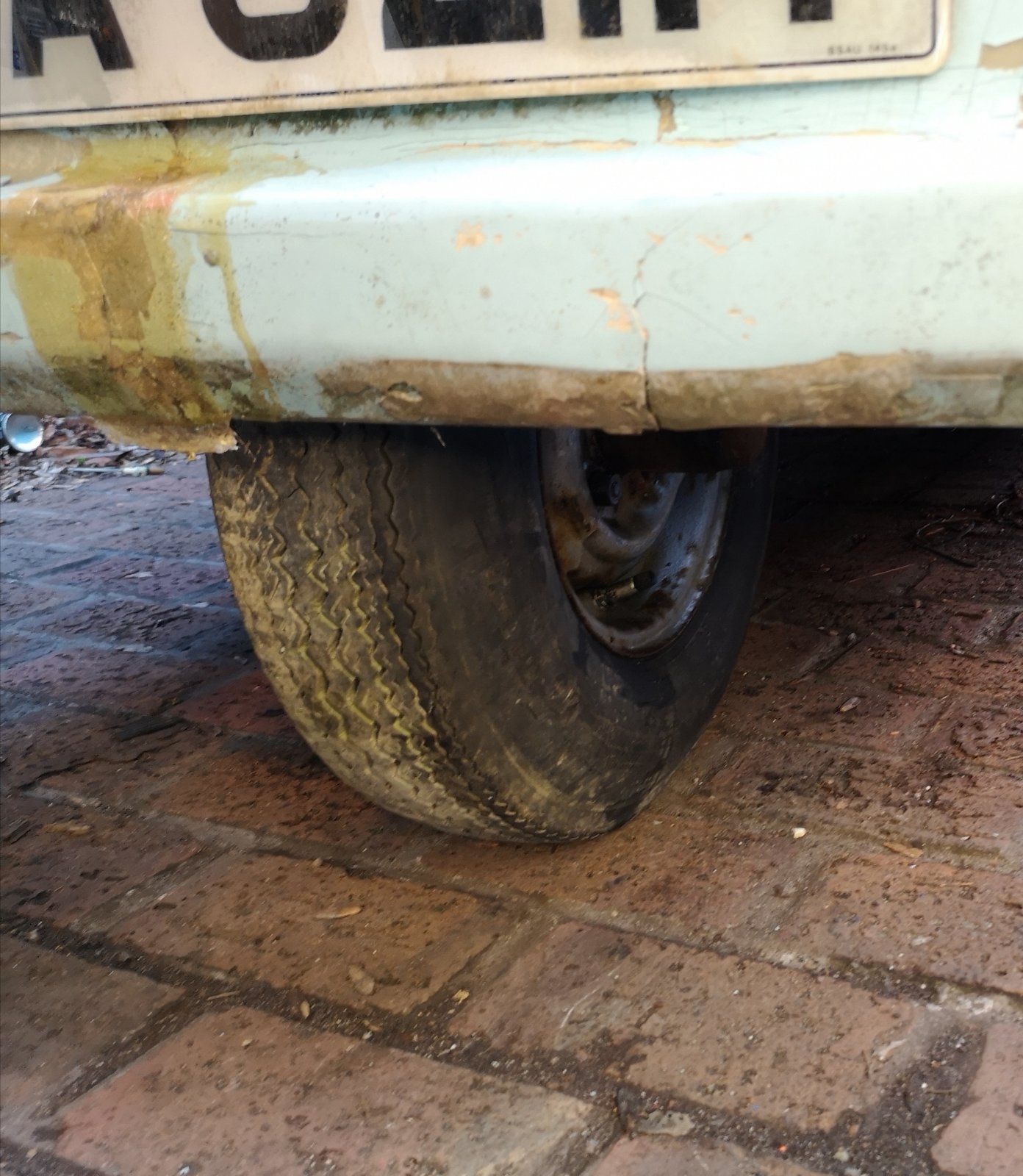

Ran out of patience with having to pump the front tyre up every single time I went to move the car, so finally dug out a spare wheel that actually holds air.
Still needs a full set of tyres before it goes near the road anyway but at least it won't go down in half an hour now! It turns out that it's totally impossible to steer a three wheeler with a flat front tyre...

I did have a good moment of inspiration earlier today with regards to sorting the bodywork. One of the biggest problems I've got is that some areas have quite large expanses of glass fibre just missing. The slightly mangled wheel arch and some general scratches and cracks are easy enough to sort. What I need for the larger areas though is - in the absence of an actual mould - is something to give some structure while I rebuild the areas in question. I'd experimented with some ally mesh, cardboard and chicken wire, but found they just didn't have enough strength and it was hard to get the precision I needed.
What I do have still sitting around from some earlier attempts at costume making are some nice chunks of high density closed cell foam. My plan is to sculpt a base to put behind the panel in question which I can then build the glass fibre over. Once there's a pretty thin shell there it's easy enough to actually build up layers over that for strength. Obviously the foam can just be removed once things are done.
Reckon it's got a better shot at working for the rebuilding of the "bumpers" than my previous approach.

Today I did manage to get the offside door rebuilt, albeit after a massively annoying faff dealing with self-tapping screws which refused to self tap. Eventually I ran out of patience and pop riveted the window channel strip on. Wish I'd just done that in the first place.
Next step: get the door seals refitted and adjust the latches. Seals were cleaned up today too, so hopefully tomorrow will see the door chapter finished.
