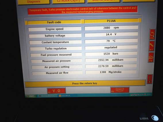

Attaching the Lexia shows two relevant faults : P11AA related to the turbo pressure being greater than permitted. And P0100 related to excessive air flow. This second fault is indicated as permanent but does clear on the Lexia.
Question is: are these faults symptomatic of a sticking turbo and can much be done without dismantling? Possibly the DPF is starting to clog up? The car has just turned 80.000 miles and these days is not used very much. with the car being an automatic and me being a grandad it does not often get driven in 'Italian' mode unless the red mist descends.

Have you a split pipe after the air flow meter that is allowing more air in than is being measured by the air flow sensor .
I am having issues with my X7 2008 1.6 so just thinking along the lines i have been down.
Think there is another sensor post air flow meter that confirms what has been measured by air flow sensor is what has been received so as a permanent fault it is always present ?

According to the fault code the Mass Airflow Meter would seem to be at fault. If that is not providing the correct readings to the ECU then it will cause the file air mixture to be wrong.
Ignore the glow plug fault, but I would give the MAF a careful clean with some MAF cleaner first, as that is the cheapest option to try first.
