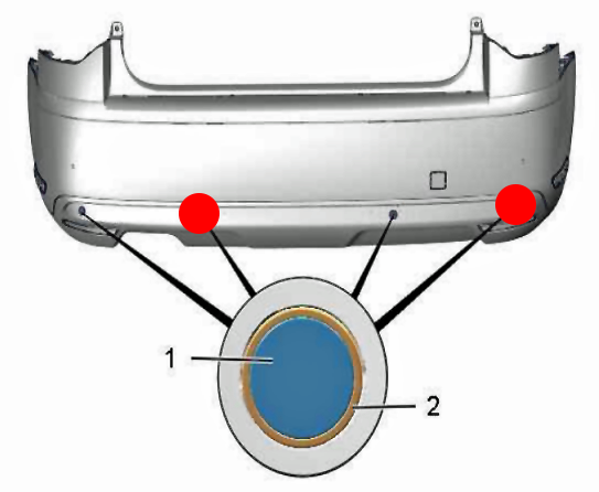

On my Citroen C5 2009 model, the rear and front parking sesnors dosn't work. I had the car diagnosed with the fault codes:
BC7: Rear left inner parking aid sensor
BC8: Rear right outer parking aid sensor
I ordered two sensors from ebay, but I dont know witch ones has to be replaced?

Re: Parking sensor dosn't work
When there is a fault with any of the sensors, the whole system is deactivated until the fault or the faulty sensor is replaced.
I've marked the ones in question here in red for you:
Thank you very much! You saved me once again. I'm waiting on the correct replacement parts, I will post pictures and the results on every post.
SOLVED! Replaced those two sensors , ordered them from Ebay. Works fine now!
