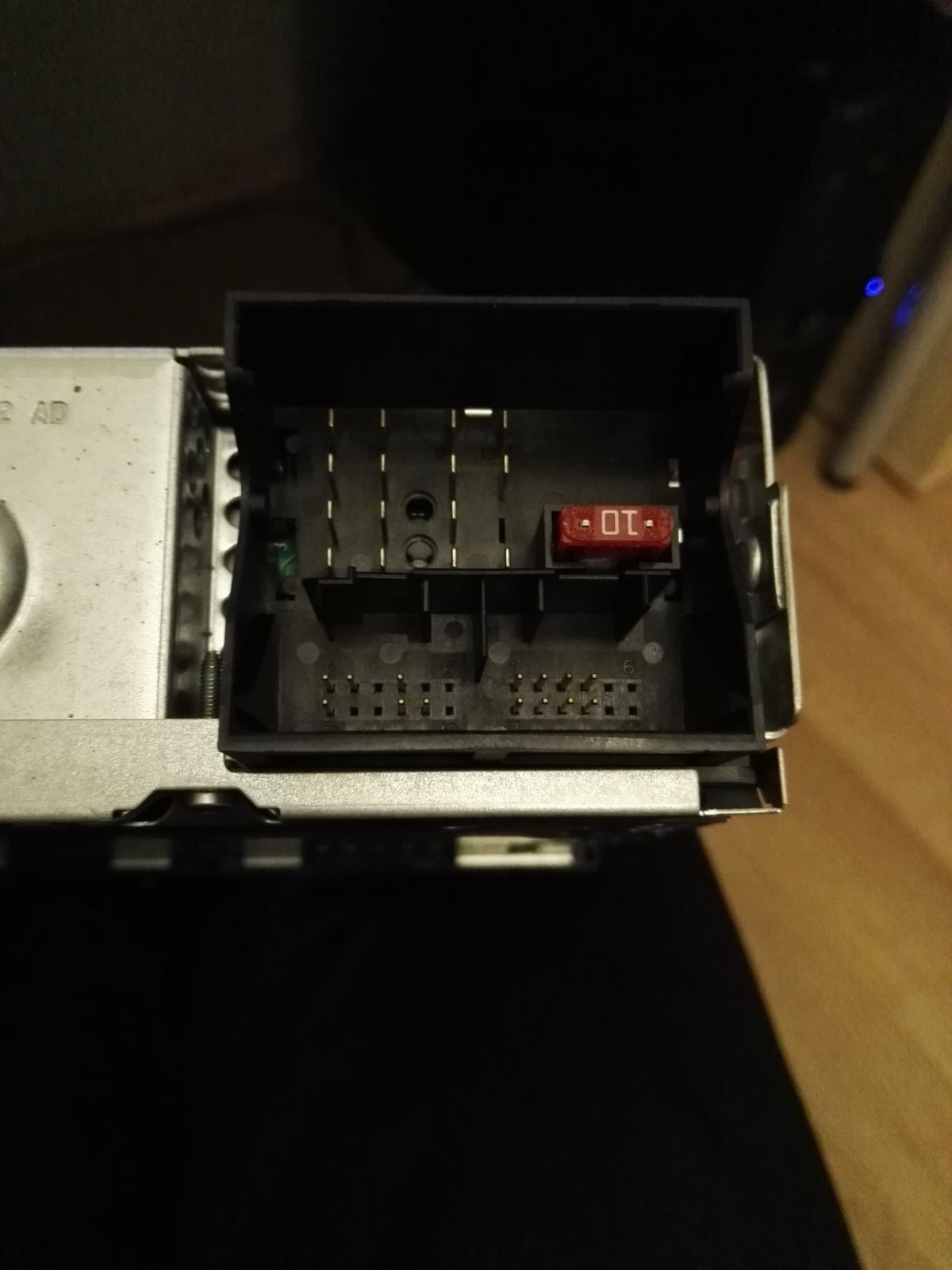

Hello Guys,
My RD45 just arrived. I started to (maybe done) install in the car… But few question again:
I checked the USB mp3 first. It plays the music from flash drive but during thism i see this on the display: (the main part is empty pls check the attachment)
Bluetooth: which connection is for Bluetooth? (there are two - attachment backside.jpg)

Re: RD45 questions + Microphone installation C5 X7 + Amplifier installation
There are no socket or pin attachments for Bluetooth. The RD45 has a built in Bluetooth module.
Hi, i mean the BT microphone.
Ok, well for the microphone it should be pin 9 shown on part B below: if you can read my hand notes!
Aaah sorry, this picture is about rd4 not the 45...
However the pin is "defined" on the mic cable connector. I hope that is ok
