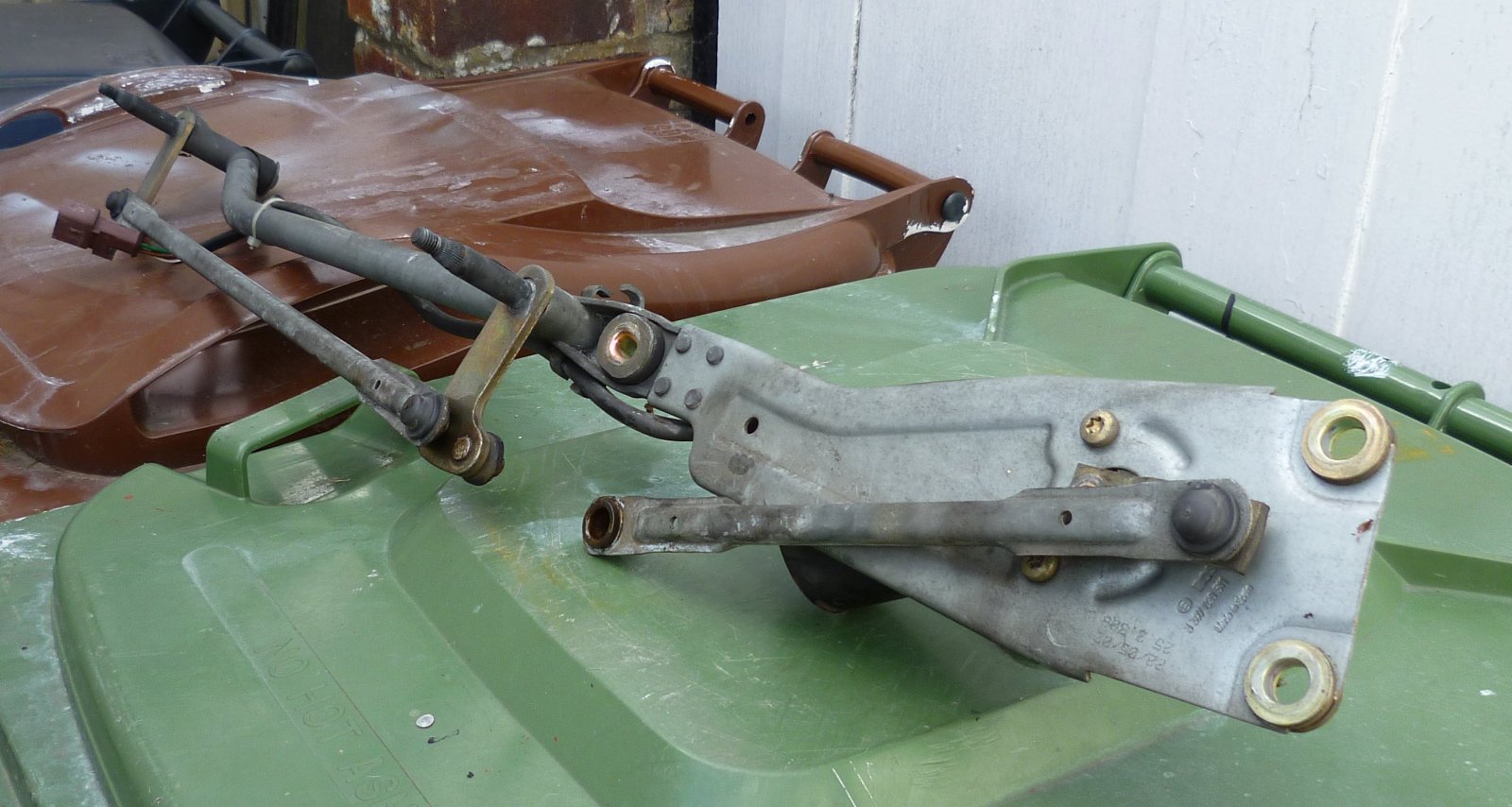

When my daughter ran a Xsara her wiper assembly broke down. I got a replacement off ebay for about £20. Here's a pic of the old one. You can see the ball joint that's come adrift.

Yeah, that's the same failure point as mine.
