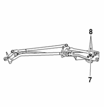

Here's the parts diagram for your Xsara:
Disconnect the battery.
Remove:
Refitting is the reverse order to removal
Remove:
- The wiper arm blades, windscreen wipers
- The scuttle grille
| Remove the clip (5). Disconnect the connector (3) . Remove:
In order to uncouple the windscreen motor, Perform the following operations:
