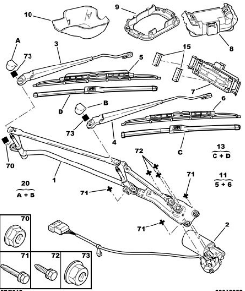

Here's the parts diagram for your Xsara:
Disconnect the battery.
Remove:
Refitting is the reverse order to removal
Remove:
- The wiper arm blades, windscreen wipers
- The scuttle grille
| Remove the clip (5). Disconnect the connector (3) . Remove:
In order to uncouple the windscreen motor, Perform the following operations:

Looks like the ball and socket joint is kaput. The mechanic managed to get it together, but it is a temporary solution.
According to the local motor factor, the linkage is 6401C4 and the motor is 6405H4.
I've taken a look on an internet auction site and there seems to be a few for sale, but the number (if present do not correlate). Is there a site which will allow me to cross reference the numbers?
Also, not sure if everyone knows this but searching for Xsara parts in eBay is a pain in the arse due to so many Picasso parts polluting the results. By typing -picasso into the search it omits any result with picasso in the title.
- x 6963
Re: Broken Wiper Linkage
Those are the correct part numbers, and the Conrod assembly is no longer available new from Citroen, although the motor is, at £243.08. I’ve had a brief look to and think you are really going to struggle to get that part nowadays.
