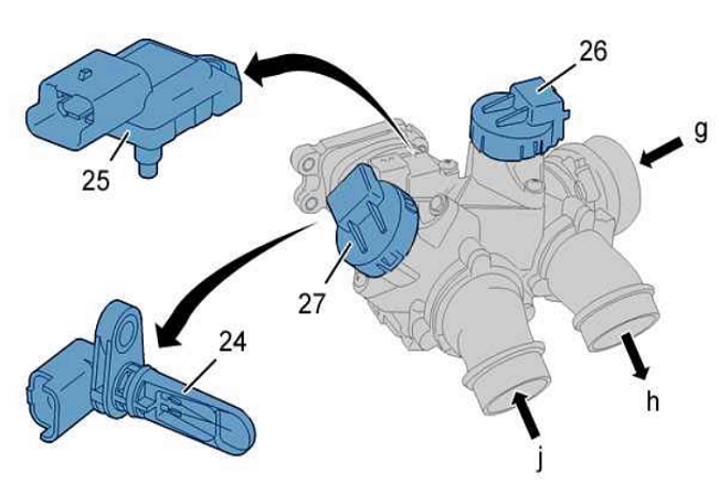

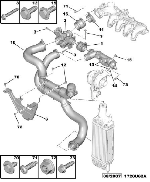

Sorry to be stupid but what the heck is Air Doser , can you point me in the direction of where and what it looks like
- x 6945
Re: C5 2008 (X7 ?) Turbo Fault
Here it is, item 3 on the diagram for location purposes:
Functions of the double butterfly air meter: (for your specific engine)
- Exhaust gas recycling (EGR)
- Help in particle filter regeneration (FAP)
- Stopping the engine
| Reference | Designation | Part number in the electrical diagrams | Remarks |
| g | Turbocharged air (hot air) | - | - |
| h | Output : Turbocharged air to the air/air heat exchanger | - | - |
| j | Input : Turbocharged air cooled by the air/air heat exchanger | - | - |
| (24) | Inlet air temperature sensor | 1240 | - |
| (25) | Inlet air pressure sensor | 1312 | - |
| (26) | Inlet air heater throttle (hot air meter) | 1361 | yellow |
| (27) | "EGR" throttle (cold air meter) | 1362 | Brown |

Right a little bit of progress i think .
Thanks to your help with the diagrams and other info i have successfully removed the Air Doser, cleaned with contact cleaner and a soft paint brush and clean cloths.
Have taken photos but struggling to get them from phone to laptop but the smaller butterfly (# 26 ) was very sticky ie did not spring back like the other one. A good clean up may have helped but also the connector when removed had oil in it, not a lot, was not dripping with it but still it should not have been there.
Now i have cleaned the sensors #24 and #25 with contact cleaner the latter actually shows metallic not black , cleaned all the contact plugs and put it back together and refitted
Cleared all the previous faults ( learning on the job with Diagbox ) and started the damn thing with fingers crossed.
Now it revs without hesitation even to close to red line, did not want to push my luck too far.
Still have the Service Lit up and the DPF warning but think that is maybe down to another part i have yet to replace.
I have done another Global Test and although i am unable to take the car on the road as it is has no insurance the only fault code that has shown up is P1351.
Will have to wait until next weekend to get insurance on it for a day to take for a spin and see what happens if it throws up the Turbo fault, a road test will always be best for results i think.
Also sprayed a lot of contact cleaner into the actuator base, as at some stage oil had found its way in there, cleaned up quite a lot so again work in progress.

Service light may go out after it has been driven a few times.
- x 6945
Exactly, as Steve says, once certain conditions are met Colin the fault may auto clear. Well done on getting this far Colin, sometimes the small simple things make a hell of a difference like a simple clean up. Good news.
MikeT
- Posts: 4808
- Joined: 11 Jun 2007, 16:17
- x 232
The turbo fault will only occur under load but it sounds like it will benefit from the cleaning regardless.
