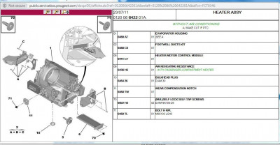

I think this is where the problem is, it seems all the Citroens have the resistors in different locations. I went to a Citroen main dealer who looked up the part number 6441CT and printed off the parts diagram (just trying to find it on Google) and he said based on that image it was on the drivers side....

Here's the pic

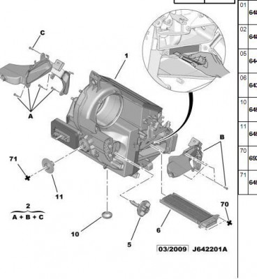

Note that these drawings are usually made from the perspective of looking from the engine bay. There's no line to indicate where the controller is, but the fact it appears on what is effectively the passenger side is where I would start looking. The similar diagram for the C3 does have a line, showing it on the pass side, under the blower....

Yes that looks very similar in position to the C5. I'd wager that the control unit unscrews with a quarter turn like the C5 does as well.
