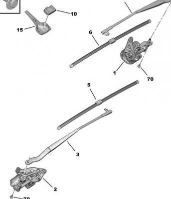

Completely different designs Paul:
C5 X7 Wiper Motors407 Wiper MotorsC6 Wiper Motors
From what I can tell just from the diagrams, the X7 has what seem to have few mechanical parts in comparison with the other 2 - and would be newer of course as the 407 run was from 2003 to 2010.
