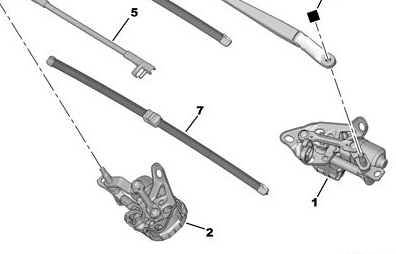

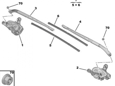

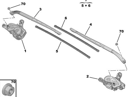

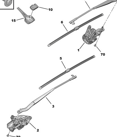

Re: Citroen C5 X7 Windscreen Wipers
Completely different designs Paul:
From what I can tell just from the diagrams, the X7 has what seem to have few mechanical parts in comparison with the other 2 - and would be newer of course as the 407 run was from 2003 to 2010.
| C5 X7 Wiper Motors | 407 Wiper Motors | C6 Wiper Motors |
