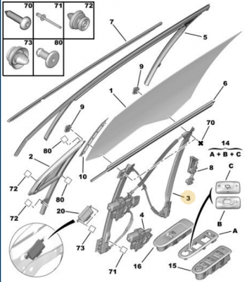

Can you help me to find the OEM number for window regulator for the passenger site? (Right side in my case)
Its broken as well 😩 wondering of buying the whole framme without motor, the wires were to complicated.
x 6954
Re: X7 Window Regulator
I've split this into a new Topic
There are 2 options - with and without motor, item 3 on the diagram.
Right hand side:
With Motor: Part No: 9675898980 £389.11 (UK 20% VAT Inclusive)
Without Motor: Part No: 1619991280 £116.26 (UK 20% VAT Inclusive)

But when I search Internett for these part number I get different frame than mine.
Heres is a pic of that one I removed from the car.
x 6954
Those are the part numbers - the plates in the picture just hold the motor on. Those pictures look the same as those in the diagram, but obviously I can't comment on the parts you have found on the internet without pictures or a link.

The original Citroen part was 9222EP for the door window mechanism (right), but was replaced with part 9675898980. This new part number is now supplied going forward, so will be fine.

Thanks, ordered one. Looking forward to get done with this car now!
