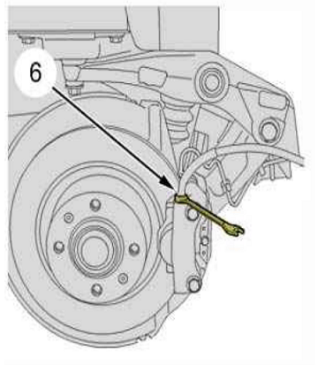

There's really no need to bleed the brakes when replacing the pads - you've probably now introduced air into the system as a result, so now you will need to properly bleed the system:
CAUTION:During the bleeding operation : Keep the fluid topped up in the reservoir and complete it. Use only clean fluid free from bubbles.
CAUTION: The ABS system must not be in operation during the bleeding procedure.
Bleeding Primary Circuit
N.B. : Two operators are necessary.
For each brake circuit:
Check the brake fluid level (between the "DANGER" and the "MAX." levels).
If necessary, fill with approved and recommended synthetic brake fluid.
If you are still having problems, you may need to bleed the secondary brake circuit, for which you will need the use of diagnostic equipment and to follow the procedure.
Front Brake Caliper: bleed screw(s). | Rear Brake Caliper: bleed screw(s) . Bleed each brake caliper in turn in the following order:
- Press the brake pedal to pressurise the system
- Couple a transparent pipe on the bleed screw
- Submerge the other end of the tube into a clean receptacle
- Open the bleed screw
- Wait until the fluid runs out free from bubbles
- Close the bleed screw
- Remove the bleeding equipment.

These positions are as if sitting in the car - yes front left = driver's side on a Left Hand Drive Vehicle."Front left-hand wheel"
