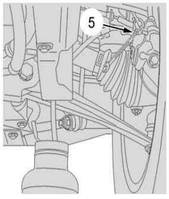

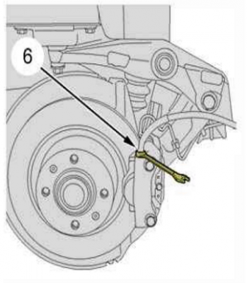

CAUTION:During the bleeding operation : Keep the fluid topped up in the reservoir and complete it. Use only clean fluid free from bubbles.
CAUTION: The ABS system must not be in operation during the bleeding procedure.
Bleeding Primary Circuit
N.B. : Two operators are necessary.
For each brake circuit:
Check the brake fluid level (between the "DANGER" and the "MAX." levels).
If necessary, fill with approved and recommended synthetic brake fluid.
If you are still having problems, you may need to bleed the secondary brake circuit, for which you will need the use of diagnostic equipment and to follow the procedure.
| Front Brake Caliper: bleed screw(s). | Rear Brake Caliper: bleed screw(s) . Bleed each brake caliper in turn in the following order:
