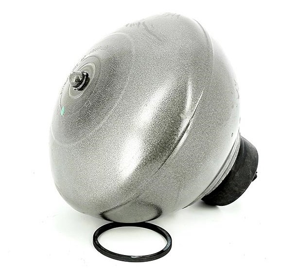

I have seen no reports of late-type saucer spheres being regassed. Pressure checked, yes. Exchangeable, certainly.
The forces being exerted on the diaphragm are massive, and it only survives because the fluid pressure and gas pressure are balancing each other, when the car is not in motion. The rigidity of the polymers used is neither here nor there. You'll need to open a couple up to compare.

Have seen spheres cut open c5 type and older Xantia Bx type . Older type very springy diaphragm and also hold more volume of gas. I send mine to pleiades they seem to be able to recharge them certainly makes a difference after they have been done.

Because the newer sphere membranes are more rigid - they fixed the nitrogen leaking issue, but when the actual membrane fails through a split , crack or crease for example, re-gassing won't make any difference for any length of time to be honest as it will still leak out. That's the reason why regassing these isn't practical.

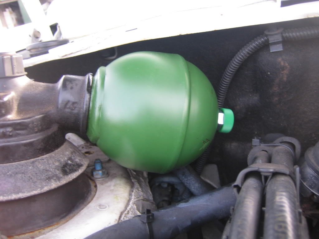

If they're for the BX, it won't be running saucer spheres, but traditional spherical ones. The latter are rechargeable (gas replenished/replaced) if they are fitted with a Valprex-type valve. The newer saucer spheres don't have the screw-in factory-fill plug (which can be replaced with a re-gassing valve), but a welded in spigot instead.
Simple76
- Posts: 113
- Joined: 13 Sep 2018, 18:19
- x 9
Re: 2009 X7 exclusive - suspension?
The traditional spherical sphere have had them recharged using original cap. Have seen them with the valve on top and they can be recharged on vehicle. The problem this posses is the sphere doesn’t get checked internally or the damper doesn’t get inspected for damage etc. The c5/c6 flying saucer type also come back looking original but can see there has been something done to the welded spigot on the top not sure how but they do something.

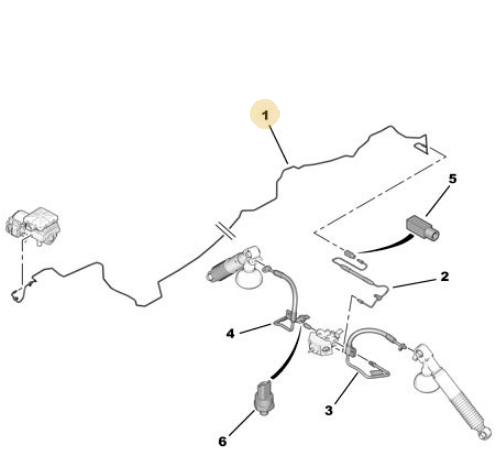

Front to Rear pipe on C5 X7 2008/9 onwards. Mine failed MOT on rotten pipe just above the fuel tank. Garage thought it was a brake pipe & broke it before realsiing it was the front to rear suspension pipe. Major problem, because they also broke the special end union into the centre rear connector, so a repair wasn't even possible. Several tries to get new OEM part from Citroen failed. Car off road 6 weeks waiting. The original pipe is 3/16 OD (4.75mm) and is made of steel with special union on each end with LDS seals. It runs from the suspension pump in the engine bay to the centre rear connection. Even if it was obtainable it would be impossible to fits as being steel there is no possibility to bend it to get it routed. Nearly had to scrap the car (2009 3.0HDI 240 exclusive), which is otherwise perfect. Nothing on any forum, but eventually located a kit sold on ebay (from Russia!) which is a pair of threaded adaptors - same male thread as the LDS unions (M10 x 1.5mm pitch) to femal brake union profile to accept standard M10 x 1.0mm pitch brake connection. Because the LDS seals areen't avaialble, the kit relies on cleaning out/ degreasing the holes then applying special sealant to the adaptors. There is 5m of heavy duty copper pipe included, which can be routed down under the car, over the tank & into the centre rear. Garage still had to drop fuel tank / remove front bumper & move anti-rol bar aside to get it through. Worked fine though & cost about £60 for the kit (plus £700 to fit !). Massive job. If you don't want to use the copper, you could just throw it away, keeping the adaptors, then buy a 5m long stainless braided flexible pipe online with male M10 x 1.0mm unions on each end.
Search EBay for Citroen C5 X7 - 9807562080 or 9807562180 which is the latest part number for the OEM Citroen steel pipe. you shoud find it then.
The title of teh ebay listing is :-
Repair-kit-9807562180-9800142780-5270vw-for-citroen-C5X7
Hope this helps someone else to find the answer quicker.
- x 6945
Item (1) is the pipe in question and part 9807562080 is for DT20C and DW12C vehicles only.
The 9807562180 pipe is for other models.
The part is showing as available from Citroen - any reason as to why they said it could not be obtained? The current price for the complete pipe is £240.55
