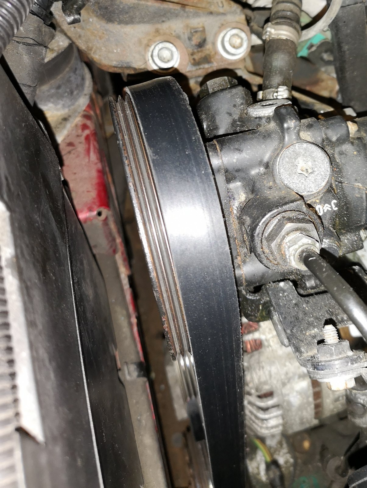

Having had the car parked up sans belt for a few weeks now I finally had a chance to look into this today.
It actually appears to be a bit more of a head scratcher than I'd thought.
Everything appeared to move smoothly and without any play, and the pulleys all look to be sitting straight.
What did catch my eye however is the shiny edge here...
I'm sure that wasn't visible before...
Having put a fresh belt on and properly routed it, as soon as the engine is started this happens.
My current theory is that the vibration damper in the crankshaft pulley has failed and the outer section has drifted inboard, pulling the belt with it. Hopefully if that's the case just a new pulley will be all that's needed.

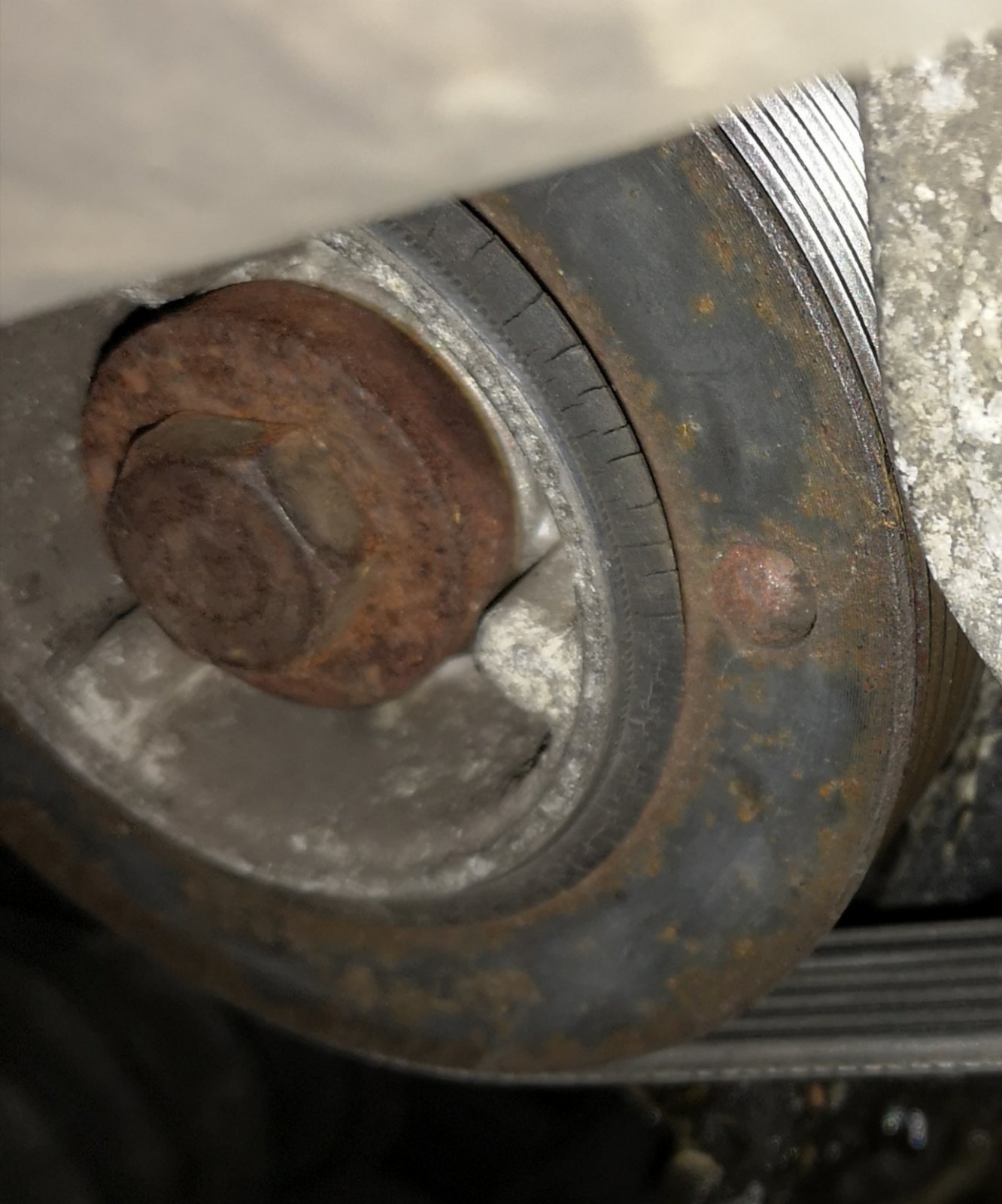

Mark the crank damper pulley from centre to outer, it'll show whether that's the problem once the engine is started, I had one that lost it's rubber, still didn't throw the belt

Reckon you're right there, Zel; certainly looks suspect. I checked on service.citroen and it's not the same pulley as the HDi which is famous for failure - but that doesn't mean it's immune!!

It does look somewhat crusty...
The belt isn't coming off there - it's suceeded in throwing it off the inboard side of the hydraulic pump once so far - and made an awful mess when it shredded the previous belt and took me about half an hour to clean up.
I might pull it off so I can inspect it better on the workbench.

That pulley is knackered. The rubber bushing between the inner and outer metal components should be smooth and intact. That is cracked and uneven, so it will not hold its' shape under load.

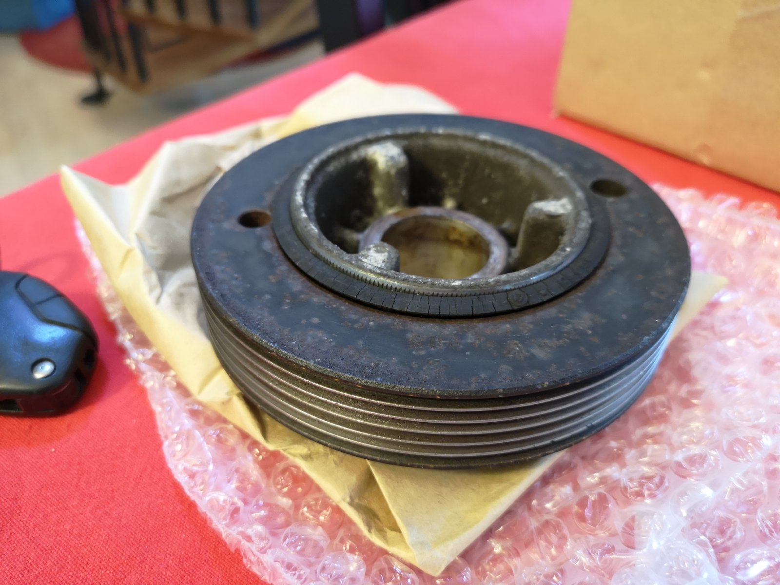

I can now confirm that the issue here was indeed a stuffed crankshaft pulley.
Replacement (part no 0515.H6 for this model) of the pulley has resolved the issue of the belt running off true at the hydraulic pump and alternator. The replacement pulley I bought was a Febi Bilstein one, part no 31102 and the going rate at time of writing was around £65. While there are some no-name ones available for less than half that, it seemed worth spending a few quid extra for a brand I trust. The Gates item was north of £100 though which felt a bit excessive.

Well 'goosed', I've heard of people fitting solid ones as replacements, if one can be sourced that is identical.

Only use a solid pulley for timing purposes... There's a good reason why it's a damped rubber one...

When I changed mine this year it looked perfect, no cracks etc.
The outer was spinning on the inner like a bearing !....(Jim saw it as well)
