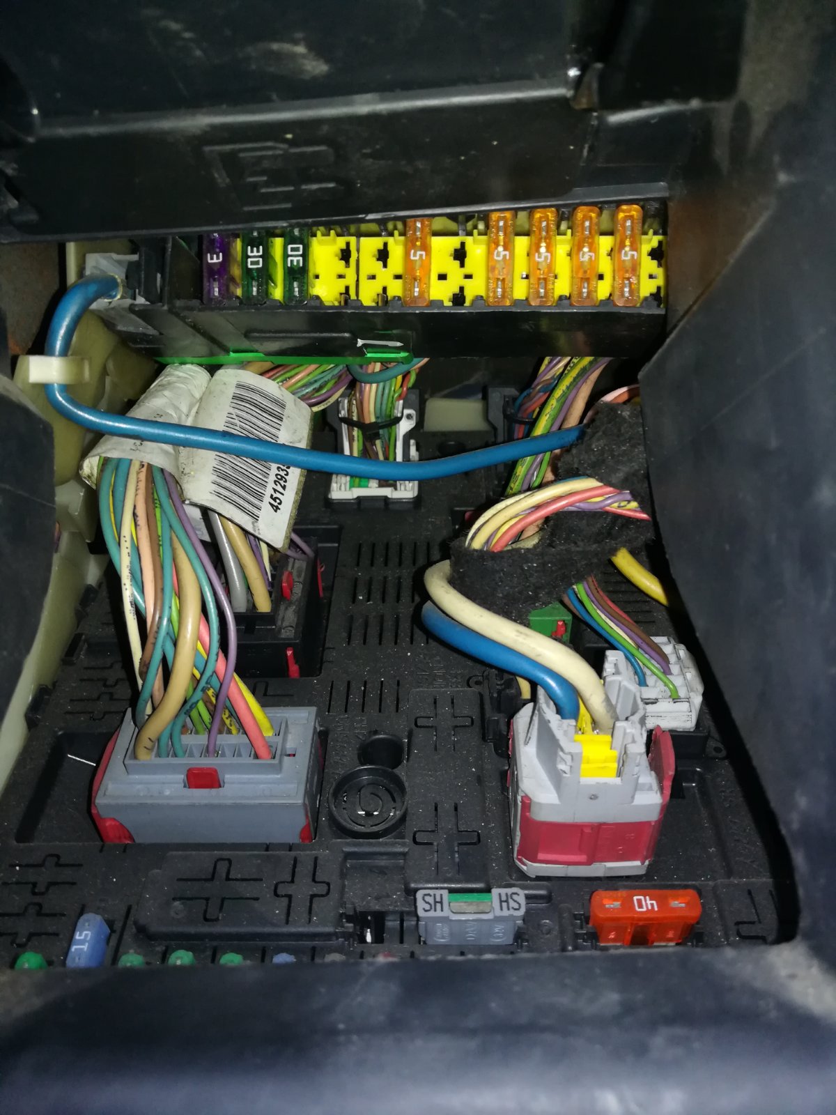

I still haven't done the wiring of the amp yet, however by looking at the BSI there is 2 blue wires that goes in 2 connections, is it a +12v ?
What about taking the power from there ?? knowing that I have a fuse on my amp cable
Couldn't find a piggyback fuse in the local store

If you look at my thread that I linked to before I used one of those two big 12v cables (white and blue) before I found a more permanent piggyback fuse solution.
I think when I checked they were both +12V

Yeah i saw that on your thread and would like to do the same I must check which one is the +12v
