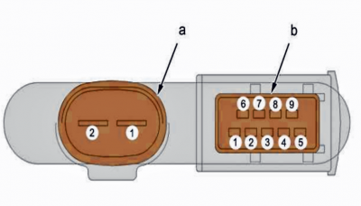

As far as the Power Steering pump itself goes, here are the components and the electrical connections, should you want to test them. Are you getting any power assistance from the steering?
(4): Electropump support
(5): Hydraulic fluid reservoir
(6): Manifold
(7): Connectors
(8): Acoustic soundproofing half-cowling
(9): Connector protective cover
(10): Connector protector fixing plate
(11): Electric motor
(12): Electropump assembly ECU (2 electronic cards and 2 temperature sensors)
(13): Electropump assembly filter elements
Power connector " a" :
Terminal 1 : + 12 V
Terminal 2 : Earth
Connector "b" :
Terminal 1 : CAN
Terminal 2 : CAN
Terminal 3 : NC
Terminal 4 : CAN
Terminal 5 : CAN
Terminal 6 : NC
Terminal 7 : Ignition+
Terminal 8 : Line
Terminal 9 : NC
x 6957

Back to this again whilst looking at the front.
Connector a) in the above diagram.
Only has one wire.
Purple.
Right or wrong.
Looked at everything.
Took all off and cleaned and put back on.
Just need to read code to see if it will delete now.
x 6957
Re: C5 2.0 hdi 55 reg power steering problem
It shouldn't work with only one wire - it will need both to make the circuit work. Are you saying both pins are there, but one of the wires has been pulled out?
