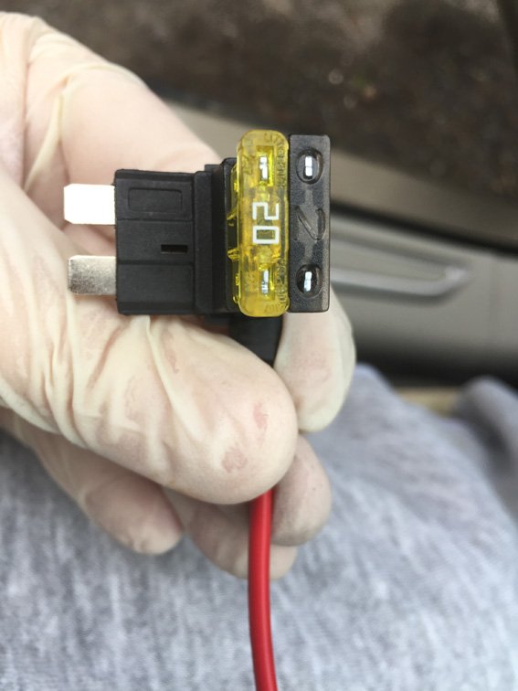

It's not really normal to make connections directly to the battery for lots of reasons. You should take a connection to the fusebox as that will provide protection for both the car and the amp. You can get piggy back fuses now, that plug into an existing suitable fuse that splits it, so that the original equipment continues to be supplied along with your amp.
You need to locate a suitable fuse though as it has to be able to cope with the power requirements. Post up your VIN here (it will be masked automatically) and I can see what options you have and identify the appropriate fuse.

| Piggy Back Fuse |

Ok, so Fuse F14 in the BSI (left hand drive - so under left of driver side cubby hole somewhere). Fusr F14 is a 15 Amp and is the one that would be used for a Citroen Hi Fi amp option if fitted. That's what I would use. It's also important that the amp switches off of course - the F14 fuse is Battery +

Ok, well F5 or F6 are both 30 Amp, so use one of those - forget F14 in that case as it won't be enough. I still wouldn't make a direct battery connection.

I ran my cable to the BSI and used a piggyback connector on fuse 4 or 6, as Marc says are 30A so can spare a fair bit of current.
Depending on your amp you will probably want a permanent live (which the fuses in the BSI provide) and use the trigger pin that the RD45 has to turn on the amp through the signal wire.
